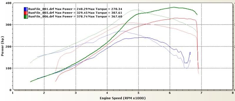

jc052685 Posted April 7, 2011 Share Posted April 7, 2011 Blue - base line as I got the car about 2 months ago Red - e85, very rough fuel tune, timing untouched from 93 tune, turbo back exhaust, single pop, 9psi Green - Same as red but on 13.5psi Quote Link to comment Share on other sites More sharing options...
BLOZ UP Posted April 8, 2011 Share Posted April 8, 2011 What turbo(s)? Quote Link to comment Share on other sites More sharing options...
jc052685 Posted April 8, 2011 Author Share Posted April 8, 2011 gt525's Quote Link to comment Share on other sites More sharing options...
jt1 Posted April 8, 2011 Share Posted April 8, 2011 Nice results. The torque curve is noticably flatter after the peak with the E85. jt Quote Link to comment Share on other sites More sharing options...
jc052685 Posted April 8, 2011 Author Share Posted April 8, 2011 On 4/8/2011 at 11:30 AM, jt1 said: Nice results. The torque curve is noticably flatter after the peak with the E85. jt That is due mostly to the tune not the e85. Quote Link to comment Share on other sites More sharing options...
