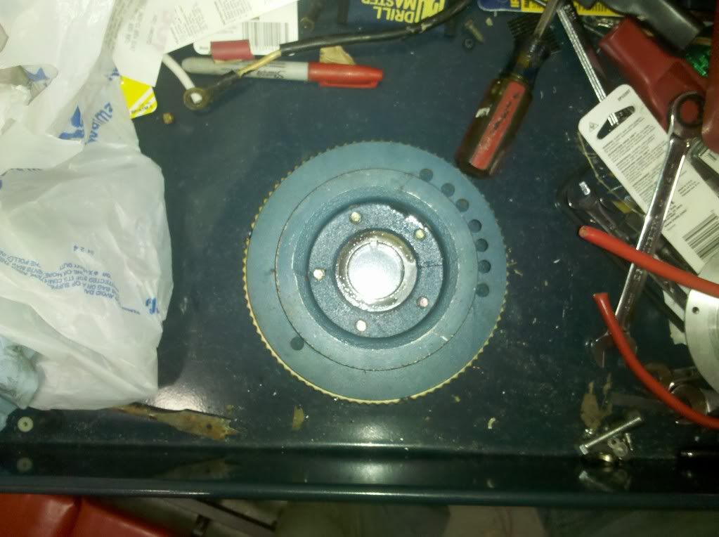

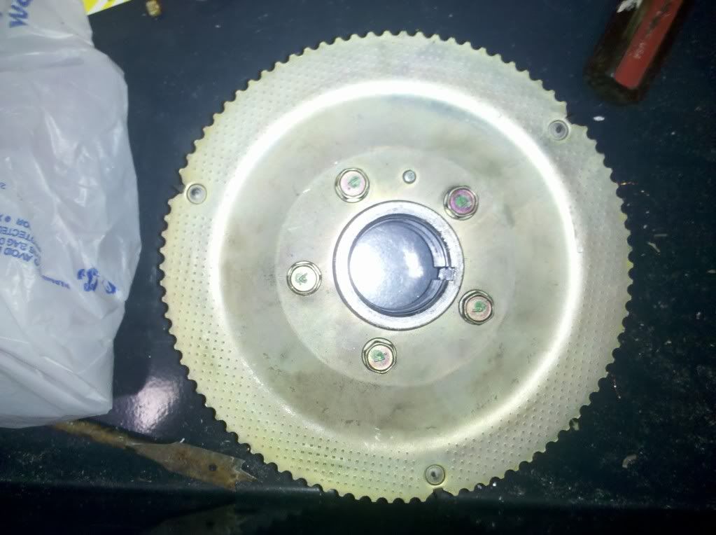

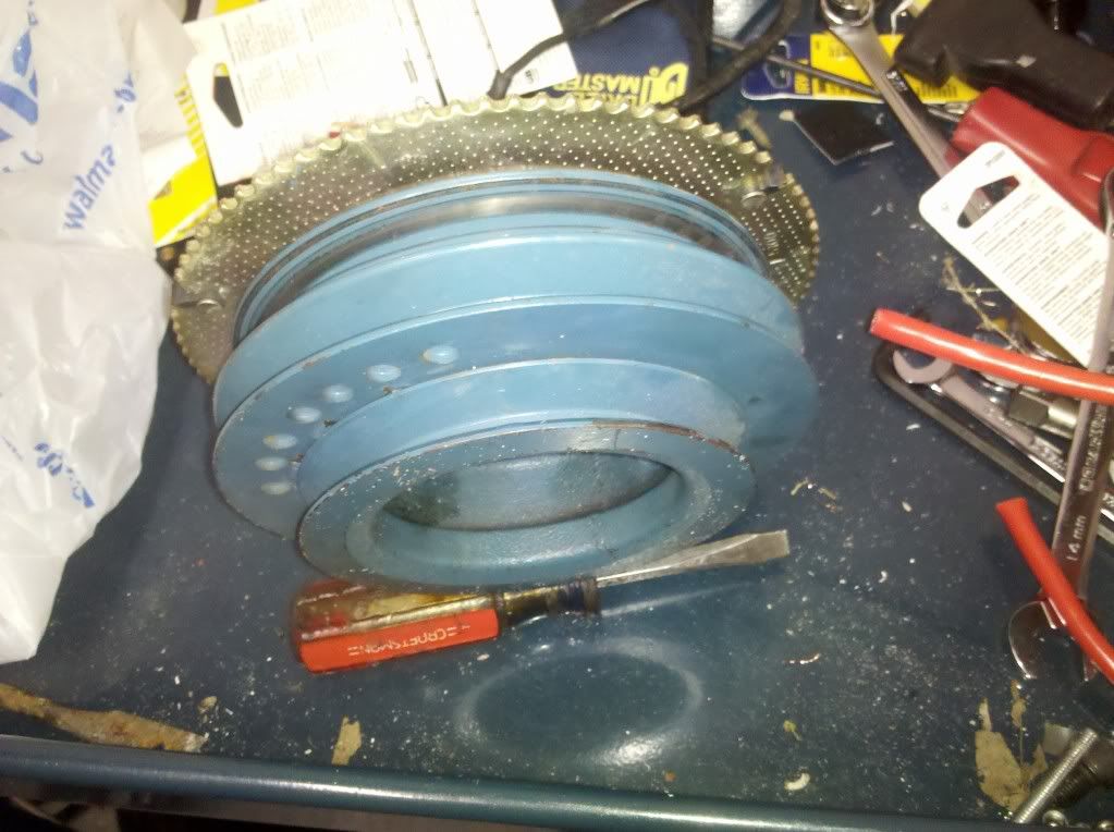

zack_280 Posted May 7, 2011 Share Posted May 7, 2011 I am going EDIS and plan to replace my damper. I actually bought the kit from Derek, but I think I'm going to try to adapt it for the slightly cheaper 'performance' damper from MSA. Or I may try to sell this one and get the 75-78 280Z damper to use with Derek's kit. Anyway, is anyone familiar with the damper below? The PO spent a lot of money on the motor, but got married before finishing the car and his priorities changed. I didn't get an explaination from him on why he used this damper or toothed wheel. It seemed a little odd since he spent so much $ building the motor and kept the car as light as possible, but then used this huge damper. Thoughts and ramblings welcome. Pic 1 looking down at an angle from the top. Pic 2 Front Pic 3 Rear Quote Link to comment Share on other sites More sharing options...
Tony D Posted May 8, 2011 Share Posted May 8, 2011 81 ZXT Stock Dampner and Timing/CAS wheel. "Saving Weight" is not applicable to the harmonic damper on the engine--serious false economy there, HUGE mistake! Quote Link to comment Share on other sites More sharing options...
zack_280 Posted May 8, 2011 Author Share Posted May 8, 2011 OK. That answers the purpose of this topic. The next question is is there a problem with replacing this with the MSA 'performance damper'? I really don't mind using this one. Acutally I would prefer it, it just seems that it will be difficult to adapt the 36-1 trigger wheel to it and the cheapest solution would be this damper from MSA. My goal is to first find a balance of the most reliable and practical solution. Practical from the standpoint of price and application. The application is not a full race motor, but will see quite a bit of time on a race track. http://www.thezstore.com/page/TZS/CTGY/PEM06 Thanks again for the help. Zack Quote Link to comment Share on other sites More sharing options...
