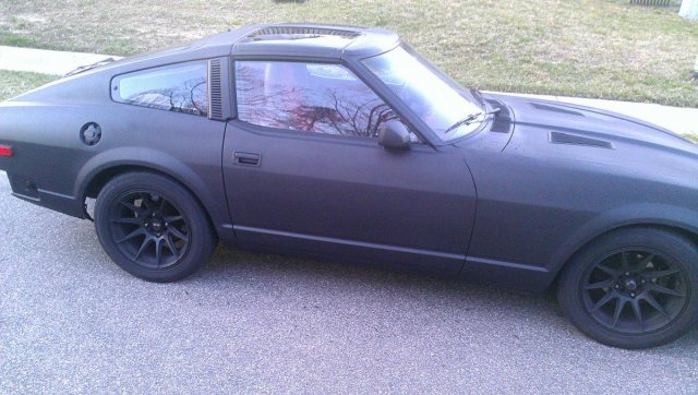

While I was waiting on the call back to get my car into the body shop for the floors and frame I decided to do some smaller cleanup work myself. I drilled out those ugly chrome and plastic side strips, sanded it down, bondoed the holes, and repainted the sides of the car. Also, I got a rattle can of plasti dip and went over all the chrome parts so now everything is black. First time using plasti dip and it came out pretty well. I'm highly concidering doing the whole car with it now.

Plasti dip sounds good, I've been trying to figure out something to cover the bumpers.  Could we get some pictures? I would also like to know how it holds up to speed.

#36 CaptainJoe87
CaptainJoe87
    Always Here
  • Members
  • PipPipPipPip
  • 210 posts
  • LocationGlen Burnie, Maryland
Posted 24 March 2013 - 11:13 AM
When you ask about holding up to speed, your asking about the plasti dip right? Dude that stuff is fine. They have a video where they take a power washer at 1800 psi and it doesn't damage it. You just have to let it cure for a day or two before you go scrubbing on it or anything. Check out their website faq's, they have a couple videos showing how to do it and the durablity. There are also a bunch of videos on youtube about it. I'm having a hard time putting pictures up from my phone.for some reason but as soonas iI get to a computer ill put them up.

Attached File  IMAG2000.jpg   174.81KB   10 downloads

Looks way better now without the side moldings.

Is the whole car plasti dip? Also I was wondering how the bumper looked.
Been watching some plasti dip videos, I'm about convinced to get some.
