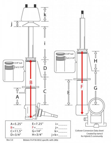

Coilover Conversion Data sheet

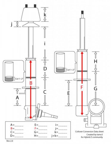

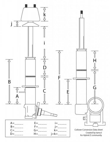

There are a lot of information on this Hybrid Z for coilover conversion. However, for the beginner, it's really hard to understand and sometimes missing data for how much length of the strut tube need to cut.
I created PDF file for your memo purpose to avoid mistake.
Coilover_Data_sheet.pdf
Hope this is useful. Let me know whether I should add/remove from the data sheet. :icon12:

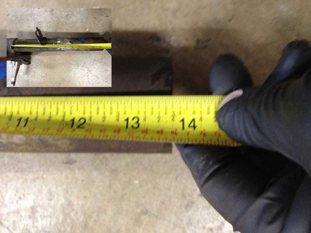

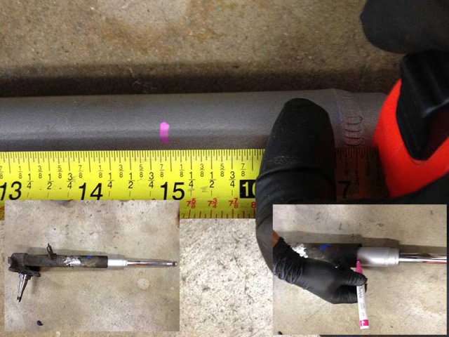

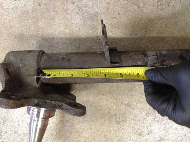

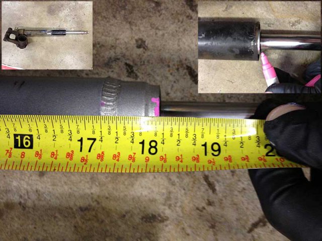

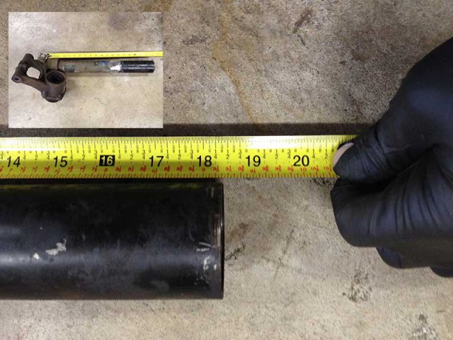

Some additional data based on my measurement.
'75 280z
Front strut
Entire length 16-1/4"
Tube Length 13-3/4"
Upto brake bracket 5"
Inside length 14-7/8"

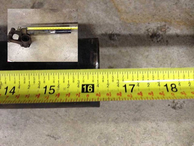

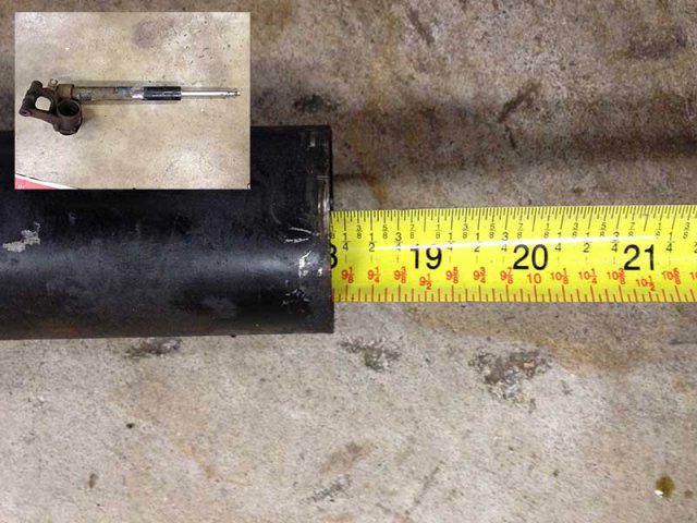

Rear strut
Entire length 18-3/8"
Tube Length 16-1/4"
Inside length 18-1/8"

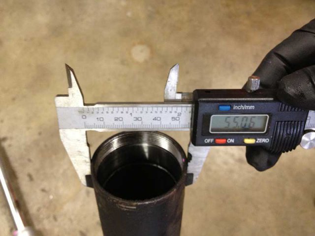

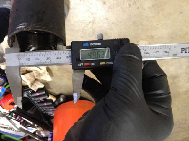

ID is about 49.62mm
OD is about 55.06mm
What I learned that important data is the inside length.
The front strut length should be same between 240z and 280z, as well as 260z.

Oops.
I update data sheet after re-reading http://forums.hybridz.org/topic/38589-strut-sectioning-faq/
Coilover_Data_sheet_rev2.pdf

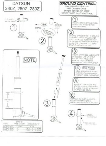

Based on John Coffy's instruction,

Front:
From the dished bottom center of the strut to the top lip the overall length should be between 12.875" and 12.938"(B measured from the inside using a tape measure. The threaded collar weld-on ring height (assuming 10" tall springs and 5" tall threaded collars) measured from the top of the spindle casting (opposite spindle) is 5.250"(A). The strut tube is cut at about 6.5"© up from the top of the spindle casting to put the welded section under the threaded collar. From 1 to 2" is cut from the bottom of the top half of the strut tube but you must measure first to be sure of the exact length as specified above. The most important measurement is the overall length of the strut tube (12.875" to 12.938")(B
A = 5.25"
B = 12.875" ~ 12.938"
C = 6.5"
Rear:
From the dished bottom center of the strut to the top lip the overall length should be between 14.938" and 15"(F), measured from the inside using a tape measure. The threaded collar weld-on ring height (assuming 10" tall springs and 5" tall threaded collars) measured from the top of the hub casting (opposite hub) is 7.250"(E). The strut tube is cut at 8.5"(G) up from the top of the spindle casting to put the welded section under the threaded collar. From 1 to 2" is cut from the bottom of the top half of the strut tube but measure first to be sure of the exact length as specified above. The most important measurement is the overall length of the strut tube (14.938" to 15")(F).
E = 7.25"
F = 14.938" ~ 15"
G = 8.5"
Tokico Ilumina BZ3099 and BZ3015 Inserts
Front BZ3099
From the dished bottom center of the strut to the top lip the overall length should be between 13.375" and 13.500"(B, measured from the inside using a tape measure. The perch height (assuming 10" tall springs and 5" tall threaded collars) measured from the top of the spindle casting (opposite spindle) is 5.250"(A). The strut tube is cut at about 6.5"© up from the top of the spindle casting to put the welded section under the threaded collar. From 1 to 2" is cut from the bottom of the top half of the strut tube but you must measure first to be sure of the exact length as specified above. The most important measurement is the overall length of the strut tube (13.375" to 13.500")(B
A = 5.25"
B = 13.375" ~ 13.5"
C = 6.5"
Rear BZ3015
From the dished bottom center of the strut to the top lip the overall length should be between 14.938" and 15"(F), measured from the inside using a tape measure. The perch height (assuming 10" tall springs and 5" tall threaded collars) measured from the top of the hub casting (opposite hub) is 7.250"(E). The strut tube is cut at 8.5"(G) up from the top of the spindle casting to put the welded section under the threaded collar. From 1 to 2" is cut from the bottom of the top half of the strut tube but you must measure first to be sure of the exact length as specified above. The most important measurement is the overall length of the strut tube (14.938" to 15")(F).
E = 7.25"
F = 14.938" ~ 15"
G = 8.5"

Bilstein specific data sheet based from the famous Coilover step-by-step thread
Coilover_Data_sheet_Bilstein_P30-0032.pdf
On his thread, thehelix112 mentioned he added 9/16" with 2-1/4" OD spacer for front shock, but he did not mentioned the length of spacer for rear shock.
Comparing with Tokiko, KYB shocks, Bilstein shock is shorter stroke. I wonder whether I need to have longer strut tube compare with TOKIKO / KONI coilover strut tube.
I can't find the appropriate inside strut tube length for Bilstein F4-P30-0032.
Edited by tamo3

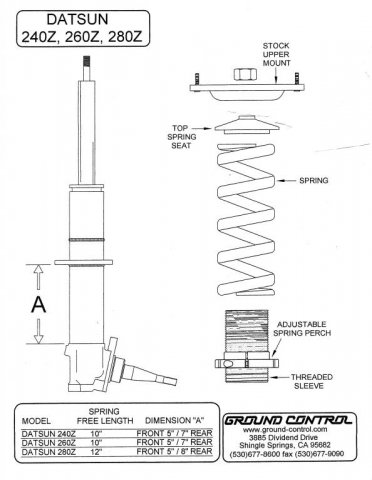

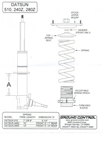

Ground Control Coilover kit difference:
240z kit
5" sleeves
10" Eibach springs
280z kit
4" sleeves
12" sleeves
http://forums.hybridz.org/topic/113548-ground-control-coilover-sleeve-length/?p=1063576
If you want to lower 280z, it's better to get 10" springs instead of 12"
forums.hybridz.org/topic/85673-ground-control-coilover-installation-instructions/
i ordered 10in springs for my 280z, and it only lists 12in for mine, guy i talked to at GC recommended 10in ones if i wanted the car even lower.
called GC control yesterday regarding my (10in instead of 12in) spring rate and installation instructions on my 280z. since it only lists 12in on the 280z and 10in 240z. the guy i talked to said even though the springs arent as tall, i still should stick to the original instructions and weld the perch 8 inches from the bottom, versus the 240s instructions (7 inches from bottom).
