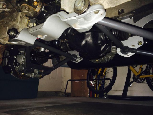

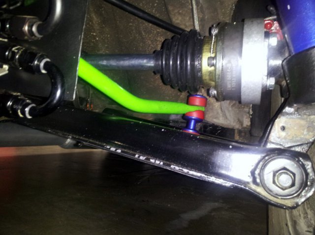

I found the hassle of a rear bar not worth the trouble. With CV axles, the link clearances are very very tight. I could get things to clear on the jack stands, then things would rub at ride height, or vice versa.
I have no problem with CV axle clearance on my setup.  When I jack the car up I have around 1 mm of clearance.  I did shorten the end link slightly for clearance at full droop (when jacked up).

Beautiful car ktm-Id rather seen 100 under car shots than a single shiny paint job.  1mm was too close for me to risk.  I could get it to fit, but not within my comfort level.  The Wolf Creek cvs are a little smaller than the Z31 CVs in the area where I was close.

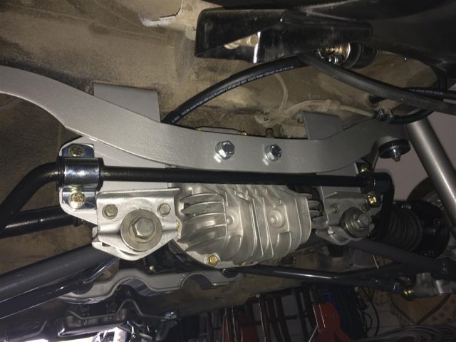

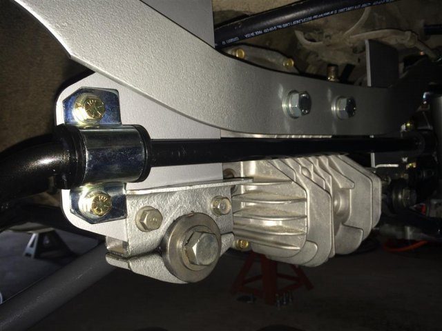

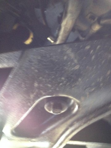

OK, so I put the ST rear sway bar (for 240Z #51075) on my 280Z with R200 CSLD w/ finned cover.  It fit without any fitment issues, but I do have to fab up a new diff brace since the sway bar runs across part of the same area.  I've got 2 different ideas on how I'm going to do it and neither are that difficult.  Here are some shots.

What was the clearance between the rear differential mount and the bar, differential cover and the bar? It looks like they are really close.
I tried to take a quick peek at mine yesterday and all I could see is that my sway bar is in front of the differential rather than behind. I need to get the car up high enough to look at it to really see what is going on under there. It's been 10years since I really looked at that and my memory is a bit fuzzy.

No clearance issues between the sway bar and the diff cover. There is about 3/4" clearance from the flat part of the mounting section of the transverse link we still have, but the diff brace is 1" wide, so "No Go" there. If the brace was 1/2 the width, it would work. I'm currently getting the new brace solution made up. Will keep you posted.

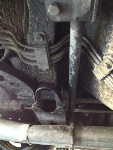

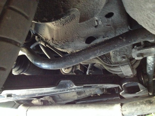

Gary,

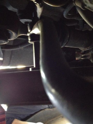

My bar is in the stock location and runs on the front side of the differential rather than the back side. See photos. In that position I don't see any issues with running the ST sway bar spec'd for the 280, do you?

If you are wanting to just go with the thicker bar in the stock location (front mount), then you should be fine.
The reason I went to the ST 240Z rear mount bar was to give me more clearance at the rear crossmember. I added a 2nd notch for the dual exhaust and the MSA rear 280Z rear bar ran right across part of those notches. While the 240Z bar is smaller, is doesn't need to be as think since it is shorter. It's a leverage thing. Here are pics of both away bars MSA 280Z & ST 240Z. I never ran the MSA bar, so it's going on eBay now that I've got the other setup.

Ok, so I got the rear setup installed with a new transverse link arrangement that allows the use of the rear mounted 240Z rear sway bar in a 280Z with R200 with finned aluminum cover. I am making up a second link like this and will post a dimensional diagram for anyone wanting to make their own. Here you go.

Really nice clean installation Gary. Thanks for the pics.
