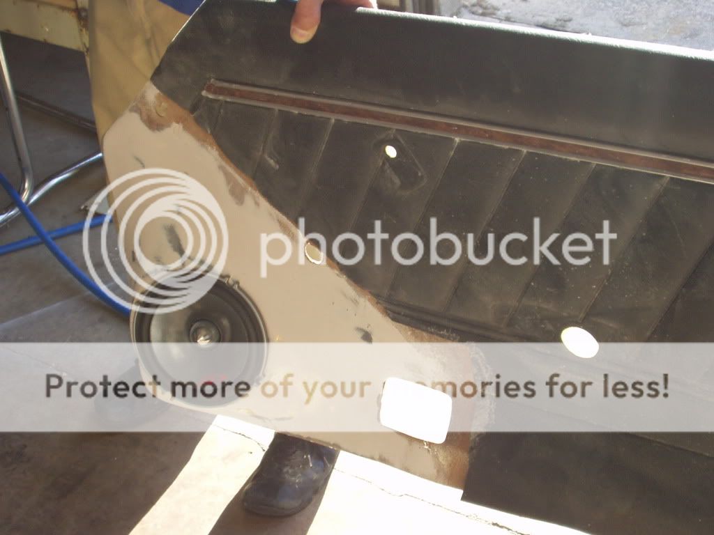

In the pictures you've shown the last (install in 240z) is the location I used. The window will work fine.
As for the uneven door panel The front of the speaker is fine as for the back I made a little "filler" piece to fill in the gap.
I used balsa wood because it was easy to work with. A contour gage and cut it to fit with an exacto knife.
Painted it black & all was good. I used that system for years.

I presume you put the filler piece under the door panel or vinyl? Happen to have any pics? I was thinking I would put the spacer under the panel vinyl to avoid any gaps and keep it looking as clean and original as possible.

The PO had already done this
And it had the gap that you speak of. So I ended up pulling it out a little bit by the door opener side. Then I screwed the east/west speaker holes to the door after the panel was put on. That sucked in up enough that it didn't stand out.
Then I screwed the north/south holes to secure the speaker cover that way the stress wasn't on the plastic cover. I also shorten the window cranks so they no longer hit the speaker. These are 6" speakers. Kinda had to work with what he had already done. Good news is it doesn't interfere with any of the door internals.

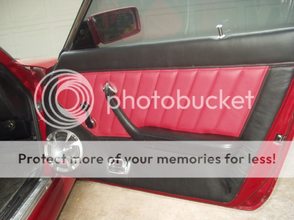

I'll attach some photos of mine.  It has 1" dome tweeters in the A pillars and 6 1/2" dual cone speakers in each door along with 5 1/4" speakers in the stock location on the sides behind the seats and a 10" subwoofer in a custom enclosure in the back.  The door panels were fiberglassed up in the area where the speakers are to point them back & up a bit and the window crank clears them fine. Only thing I had to do was shorten the outboard end of the hood pull lever to clear the one on the drivers side.

That looks great Phantom! I'm guessing you did the stretched fabric method to shape the pods? Did you have to cut the doors as well for clearance? This is the most elegant looking install I've seen yet, only thing is I was hoping to avoid upholstery work. I'm wondering if I can take the upholstery off the door card, add a pod, and conform the original upholstery back over it again.
Good to know you can fit 6.5" speakers, but I think I'll stick to 5.25" for ease of install.
Any tips on running the speaker wires?
Drilled holes in the end of the door and door frame. Inserted small rubber grommets and ran the wire. Some guys just run the wire between the door panel and kick panel for simplicity but that leaves the wires visible. You'll need to be sure to leave enough slack in the wire for the door to open.

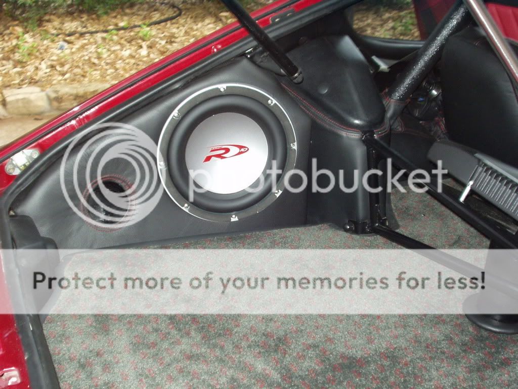

I spent the rest of the day working on the sub box, but here's a recap.
First I cut out the spotwelds holding one of the jack brackets that protrudes into the spare tire well. Any other protrusions were covered with duct tape. Then I lined the whole area with tinfoil and masking tape and built some MDF walls around the perimeter.
And presto:
10" Phoenix Gold slim woofer (only 4" deep) mocked in place.
And the top complete. The sub is recessed 1" into the box, which sits below the stock false floor in the 280Z. I will duplicate the false floor panel but with a hole cut out above the sub and covered over with expanded metal plate. Stock carpet will lay down over leaving the trunk entirely stock looking and fully functional (just no spare tire in the original location)
