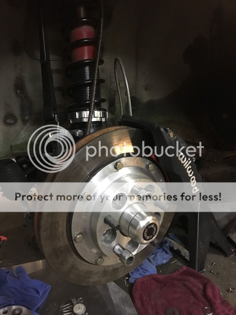

Got all this put together today. Caliper ended up perfect after I had to shim the inner bearing out. The hearings are closer together on the gm stuff so the outer bearing was binding on the spindles taper just before getting tight enough. So I found .030 worth of shim for a pinion, this was enough to get proper preload without bearing binding and proper caliper alignment
I'm pleased with the results, you can actually feel the weight difference in just spinning the rotor.

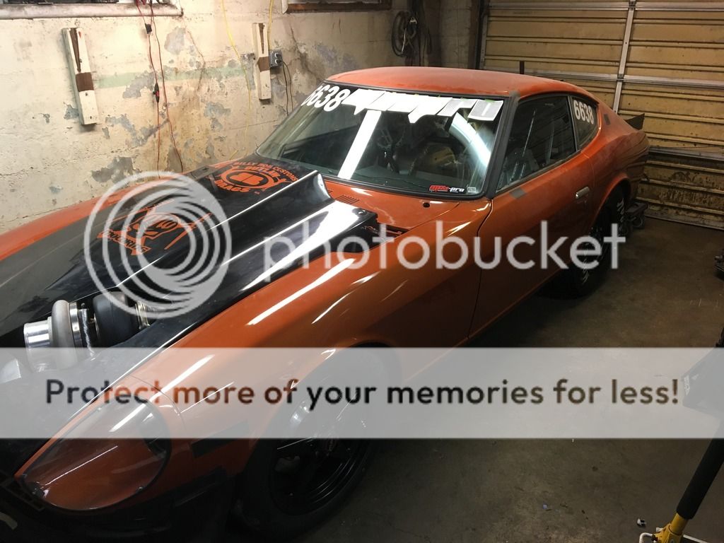

Well, got this project track ready. Racing begins next weekend with a local 1/8th mile top ten series

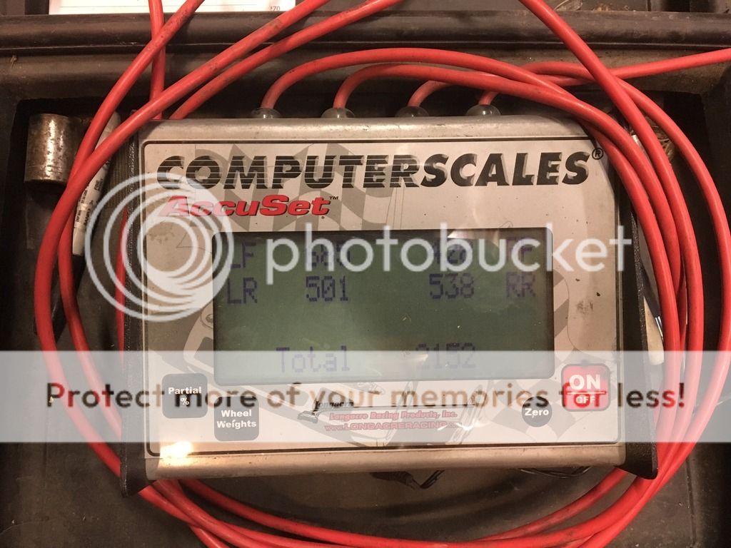

Borrowed some scales from a friend and all my hard work paid off over the winter. I was rewarde with a 2152lb race car with it 2326 with all safety gear and me in it
