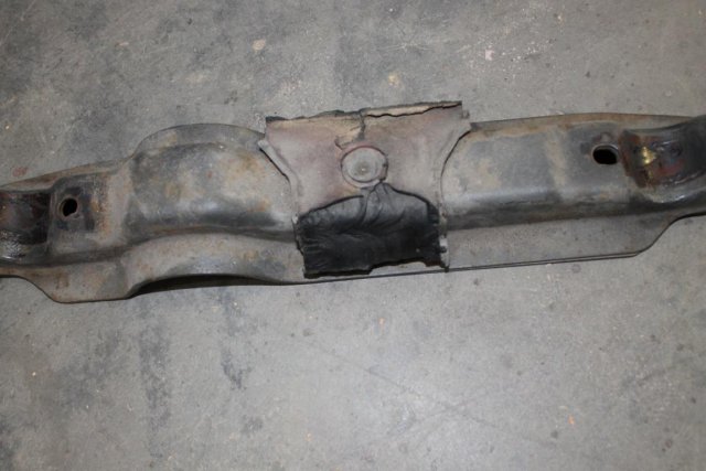

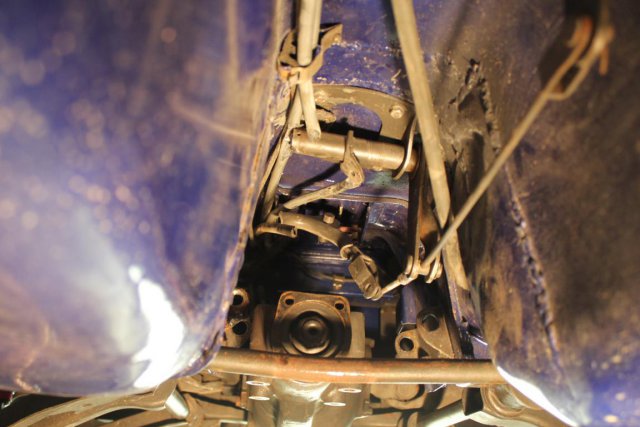

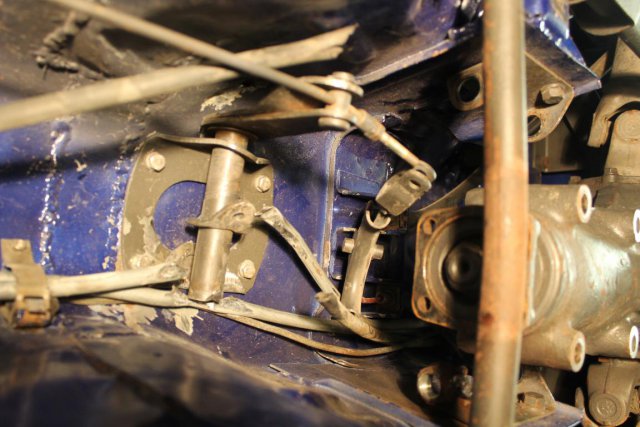

Oops
I keep finding weak spots. But I correcting them as they show up.
