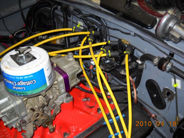

Some pics of of the Ignition System I have been working on.
It is a Ford EDIS/8 system that will be controlled with a "MEGAJOLT" programmable Ignition unit.
I made the trigger wheel from an old flexplate and a piece of 10ga. steel.
I also shot an pic of the controller.
Edited by MONGO510

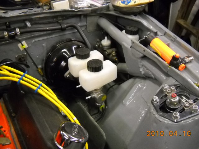

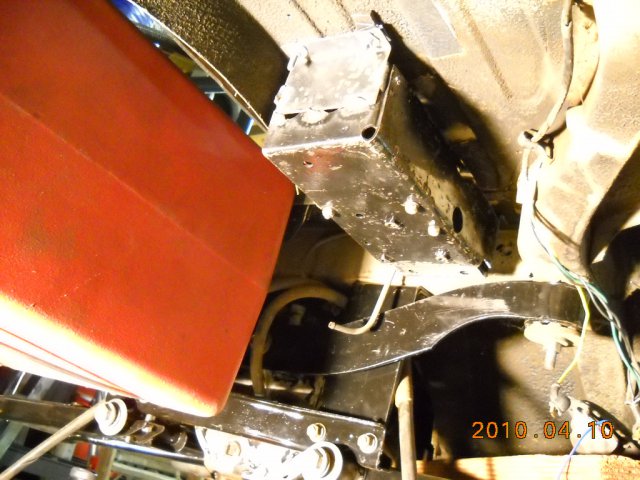

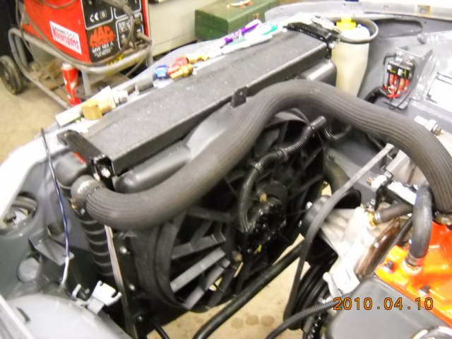

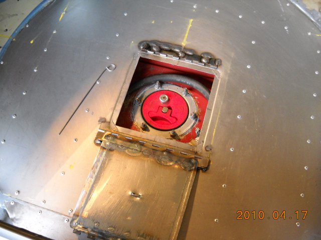

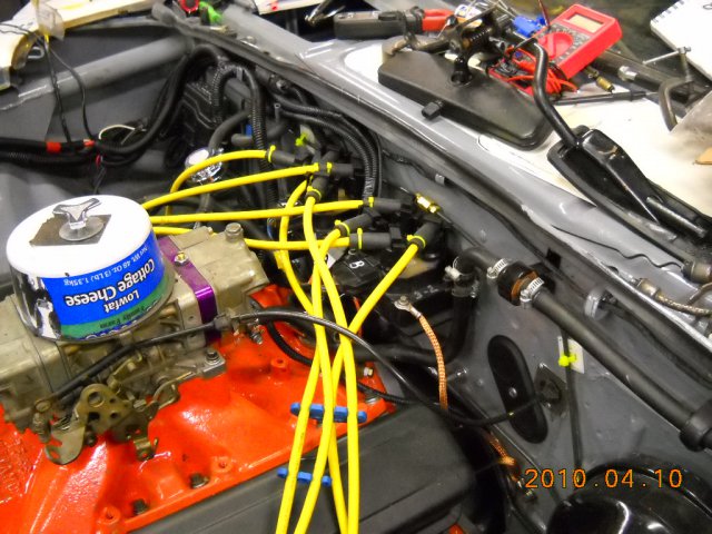

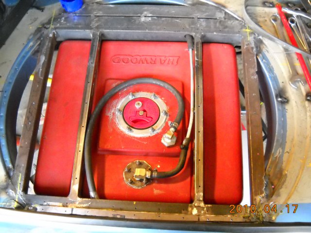

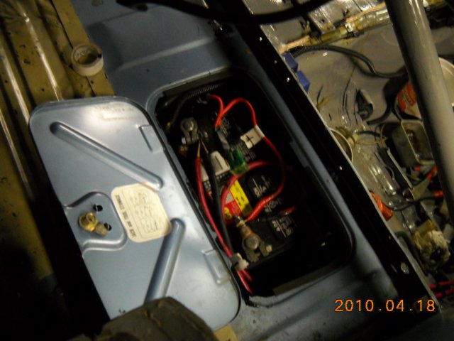

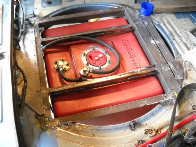

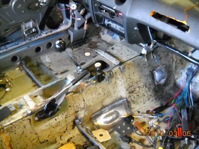

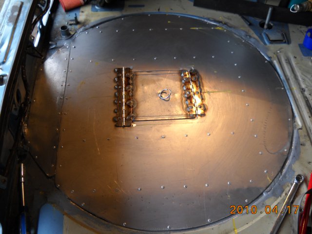

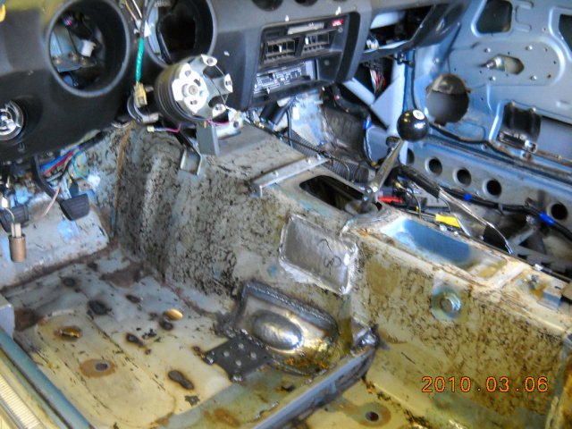

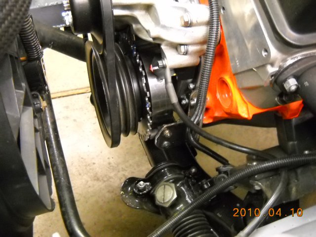

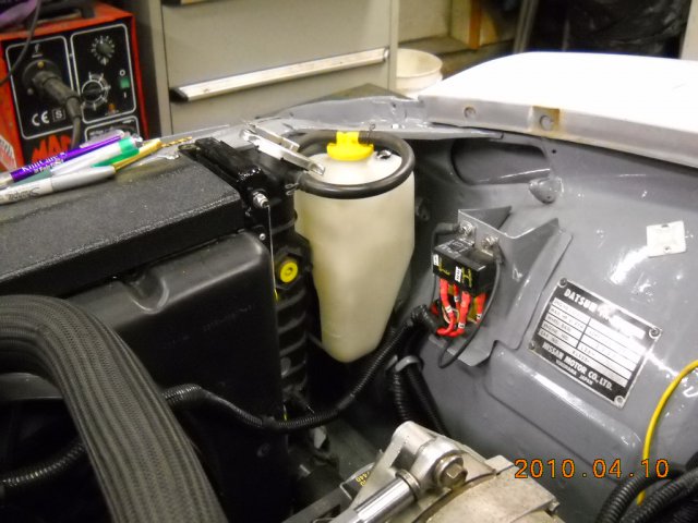

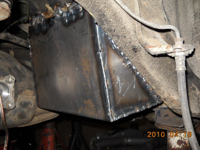

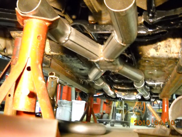

Its been a while since I did an update, so here are some pics of what's been happening.
1. EDIS ignition is up and ready to go.
2. Radiator, Fan, Shroud, and Expansion tank are installed.
3. Fuel tank is installed.
4. rear floor sheetmetal is installed.
5. Wiring is almost done.
6. Install inspection plates on transmission tunnel.
7. Install battery box in pass. side storage compartment.
8. Reposition original fuel pump mount with new pump installed.
9. Fabricate exhaust crossover section.
Mongo
Edited by MONGO510
