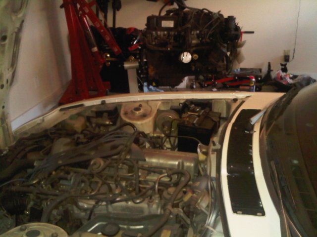

Ok, so here is where I am at right now in my l28et swap into my 82 N/A:

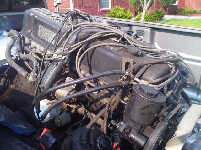

-Got a "running" (haven't seen it run but was told it was running good) 82 turbo motor from greg (autosport) down in panama city
-Turbo in great shape, no shaft play whatsoever, has possibly/most likely been rebuilt
-Pulled exhaust mani/intake mani, both in good shape but broke one stud
-Valve Cover (cam and valves and chain seem good to me)
So after reading endlessly of people making claims of close to 300 hp (reliably?) on the stock bottom ends, I am beginning think, why rebuild it? (My initial plans were for a complete rebuild). Even Tony D pointed out in quite a few posts basically, "If it aint broke, dont fix it" type mentality, which as an engineer I can relate to. However, pulled the oil pan yesterday and found a small pile (Kennedy half dollar size?) of metal the size of which was in between "chunks and shavings". Of course this set off some alarms, and while it wasn't a significant amount, it wasn't something you could ignore either. At this point I am going to try and run a compression test tomorrow and see what I find, if it was running it should ::winces:: be good. If does indeed check out, should I bother with new rings? (I am still planning on new HG and ARP studs). Also going to pull the rod connectors and get a look at the bearings, if i can see copper, I think I am going to have to break down and do the whole rebuild. Also, can the stock rod bolts and mains be re torqued? Or are they a one time only deal, I figure I can/might as well do arp on the whole bottom end while I am at it.
