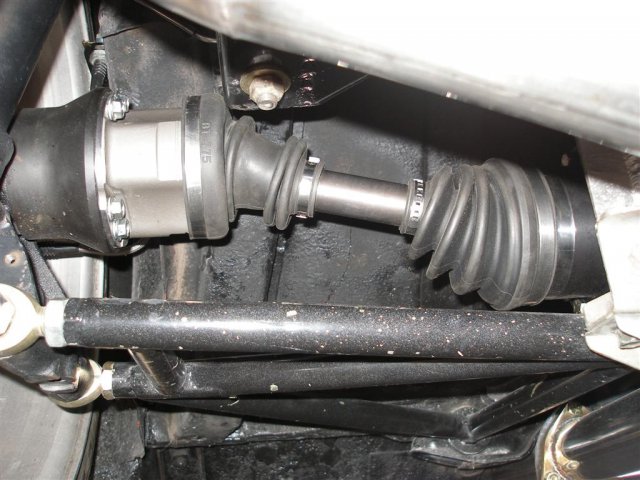

  3. I just got the new boot and straps in the mail. I plan on pulling both sides and re-checking them...it could be as simple as having them swaped. The builder said that should be the first thing to check. The driver side is shorter, so since he left no marking or reference on either of the shafts I might have them backwards. As far as the over agressive angle that will have to be figured out next. I will post some more pics when it is back together. Thanks Jon. jh

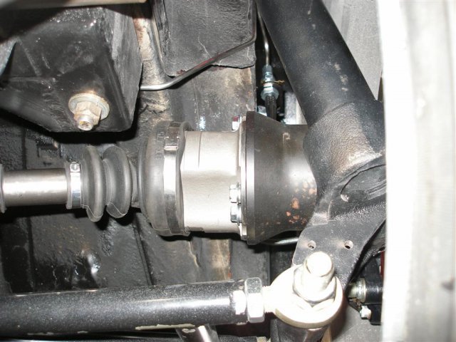

  4. Here is a shot of the driver side. The car had to be raised to drive it since the half-shaft was resting on the frame.

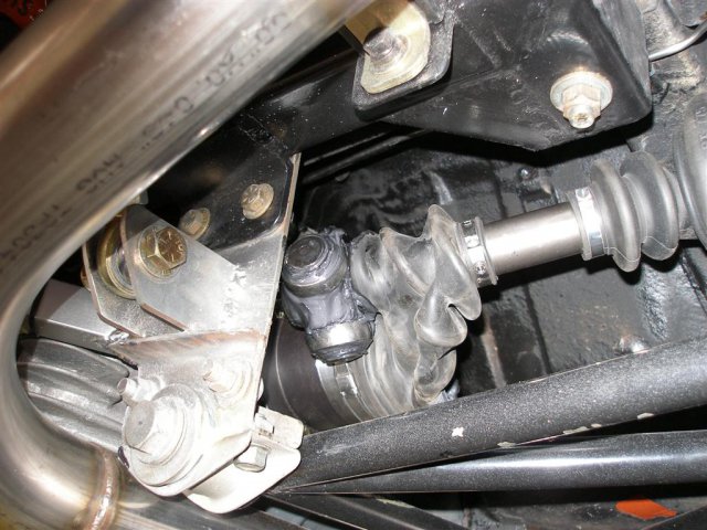

  5. This is a pic from under the car. It looks like it was just over articulated and popped out. The shafts are completely custom as are the stub axels and companion flanges. This makes the length of the shaft itself very short. Short middle shaft, wider couplers on both ends, end result is too steep of a shaft angle. I was told not to exceed 20 degree...when I measured the shaft it was at 16 degrees already! WHAT DO YOU GUYS THINK? I hope that I'm approaching this problem correctly as the parts on this car aren't cheap. Thanks. jh
  6. Well it was about 3:30 in the am this last Sunday morning when something went bad. I got the brake lines plumbed and bled, fixed the power steering leak, adjusted the suspension, mounted the half-shafts and did a full once over on every bolt and system. I strapped in, and my buddies started to push the Z outside so I could break in the diff. Just as we hit the tarmac there was a loud thud from under the car. It sounded like an inpact or something. We got the car back inside to find the passenger cv had punched out of the boot and spilled grease all over. The angle seems to radical so the knuckle popped out. I have a new boot and straps on the way but it looks like I have to raise the entire diff up in the chassis about 1.5 inches...so maybe I will have it running this weekend. Learn from my mistakes, it is better to walk away and come at the project with fresh eyes than to press the issue and break something. Talk to you all later. jh
