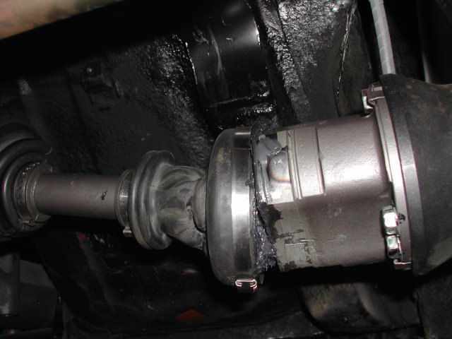

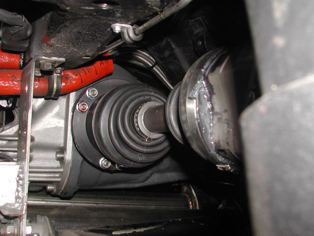

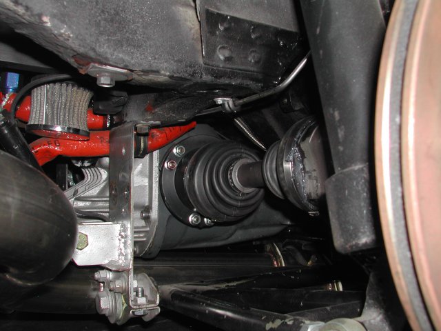

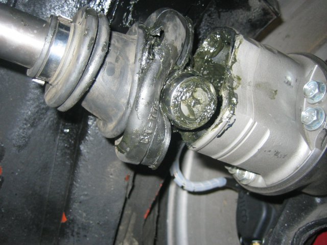

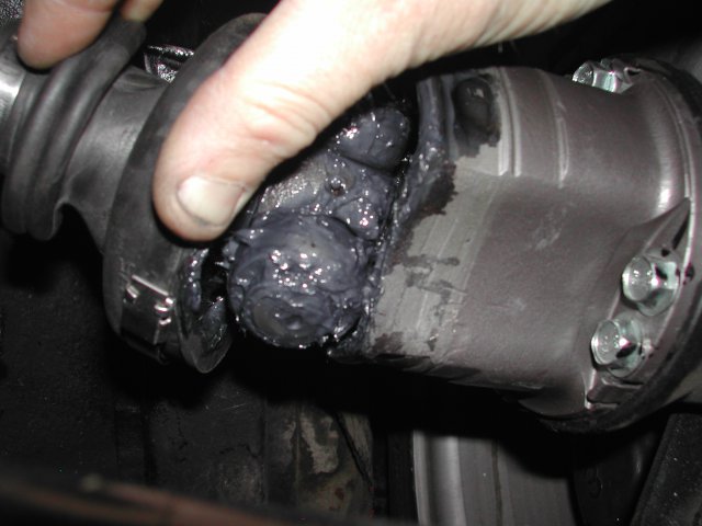

I removed the pass side and noticed something interesting. When this all began and I first got the shafts they were built using the factory outer hubs. I cleaned out the excess grease and saw that the stock retaining nubs are almost wore down. Now regardless of the overall length of the cv's once the vehicle builds up enough rotational speed the inner tripod bearings are just walking past these nubs. This in turn is causing the shaft to break apart. I do think the car must be raised up but the diff has been raised in the chassis and centered with the outer hub. I feel the only way to fix this problem is to have custom outer hubs built that have some sort of retaining housing or clip. I've added a few pics so you all can see what I mean.
The diff is a R200 with a Kaaz two way center section. The cv shafts are custom from "the driveshaft shop". They are based on the 280ZXT style with 300M shafts and custom inboard cups. To tell the truth I have had nothing but problems with this mod. I should have just run a Subaru, Jag, or Chevy system. I talked to the guy who built the shafts today. I sent him some pics and discussed the issues. He still swears that I have too much travel, bad geometry, or misalignment. I have checked everything more than twice and the shafts have got to be short. Quite a few of you guys have some high output road and race cars and I'm wondering what is the standard set-up to run on these cars? If I don't get some seat time in this car this coming season...I will loose it. Help me out if you all have any answers. Thanks

Yes, the wrong length. I'm not going to bad mouth the quality of their product, I just wanted to now if this was a common error. I did check out that post. Man, what a beefy looking set-up. I heard the stock 230 diff and shafts can handle well over 450+ from the factory.
So Mark, Stony neither of you guys had problems with your half-shafts? I questioned being able to recommend these guys to anyone else after my run in.
The shafts were built by the DriveShaft Shop. I was told that they are the guys to go with for custom stuff. I'm sure they usually do great work, but not this time around. The shafts are approx 15 inch long with stock outer cups(reconditioned), center shaft is 300M, and the inboard has custom slipers that allow track adjustment for slicks. I chose the Stage 2 upgrade which rates these around 600bhp/torque. They are originally from a 81 280ZX Turbo with the R200 diff. The outer stub-axels are custom built from Moser Engineering via Modern Motorsports. As for lowering, the Z has been dumped down to a 3.875 inch ground clearance ...which isn't alot but it seems to clear ok.

Hey all. I just received a call from the guys who built my shafts. All this worry about articulation, geometry, and installation was for nothing. My problem was due to the shafts being made 1.5 too short! The tech told me how sorry he was for the mix-up and that " I rarely make mistakes " ... in his words not mine. What a joke. I hope he pulls his head out of his rear long enough to fix the issue and not make excuses for it. He promised that I would have them before the years end. I will keep you guys posted. jh

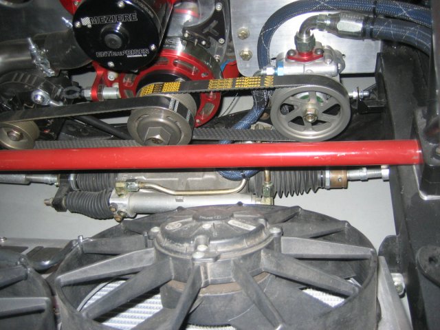

Darius, nice work man. I know the feeling...it is just like a big freakin go kart!! As for your lack of power steering try running an aftermarket set-up like I did on my Z. It is an Appleton power rack, not too expensive, easy to mount, and a bunch of ratios to chose. I went with the 2.0 lock to lock and I'm running 305's in the front and it works great. Anyway, impressive work dude. -
Yea Mark your spot on about the shafts. They do have a lip on the inner egde to keep them inside. What I didn't show in the pics is the damage to inboard cv cup. The knuckle hit the back of it so hard that it punched about a one inch impression in the steel. The entire assembly will have to be rebuilt. The builder will have to asses the scope of the damage...but that is too soon to tell. I think my length was closer to 15 inches and yet it is still not right. I hope they get on it quickly. Take it easy. jh
