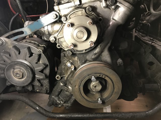

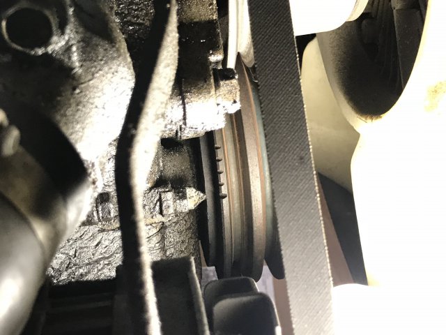

So I got the 36-1 wheel mounted and my EDIS is working . But... Does anyone know of an easy way to center the wheel on the damper. Mine is off just a touch and I can see a wobble of about 0.02 thousandths. It's not off by much but at 7k rpms that could be bad. I was thinking of putting a bolt in the crank bolt divot and see if I can center it up that way. I really don't want to pull the damper off if I don't have to. any Ideas? Thanks, Matt-
Hi there, need some help. I am building my edis system and I want to make sure that I have my wheel mounted correctly. I have the timing pointer at 0 degrees (TDC) and then I have the VR sensor pointing at 6 teeth left from the missing tooth it looks like this ... please let me know if I did it wrong. Thanks, Matt-

Alright! The bolt holes are M6-1.0 the reason they wouldn’t work for me before is because they were so full of rust and dirt that nothing could be threaded. I cleaned them out with an M6 tap and boom M6-1.0 works perfect! Mystery solved!
I just tried 1/4-20 nope why the F would they make a thread that can't be found Why Nissan WHY!!!!
I can not figure out what size bolts go in the front of the pully. I bought M6-1.00 and that only threaded in one thread. So I'm guessing the pitch is off? are they M6-0.80? there were bolts there to secure the pully for the power steering pump right!? So what size are they

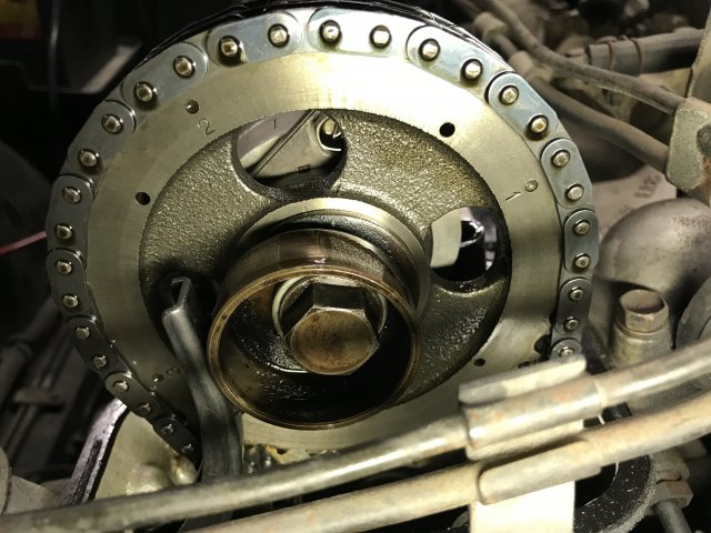

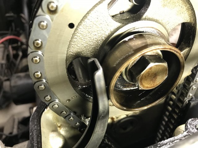

I took a few photos. I checked the timing and it looked fine except... the bright link was on the 3. Isn’t it supposed to be on the 1? I know the 1,2,3 are for timing chain stretch but my timing chain has maybe 20 thousand miles on it and I’m pretty sure when I put the head on I had the shinny link on the # 1 position. 🤔 then I started thinking about it... doesn’t the bright link move around with every rotation of the engine🤷🏻♂️ Man i suck at this. I finished my valve adjustments. They were almost all about .001 to tight. I retorqued the head bolts to 60 ft/lbs. I think they were torqued to 55 last time I put the head on because I was able to turn it a little tighter until I got a click at 60lbs i ran out of time to run a compression test so it’ll have to wait till Tuesday.
