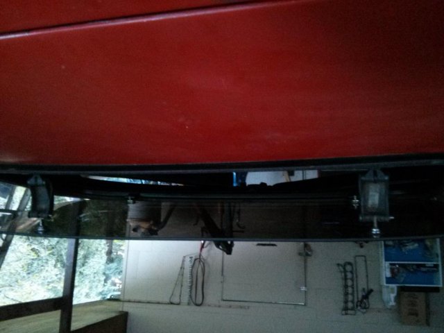

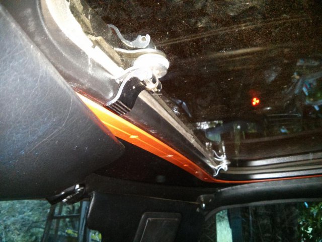

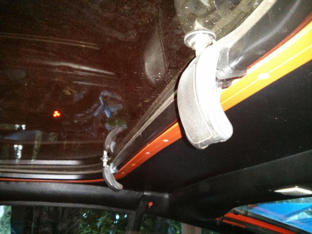

	I need to buy another latch now that I know it fits for the other side and a urethane mold kit to make a new seal

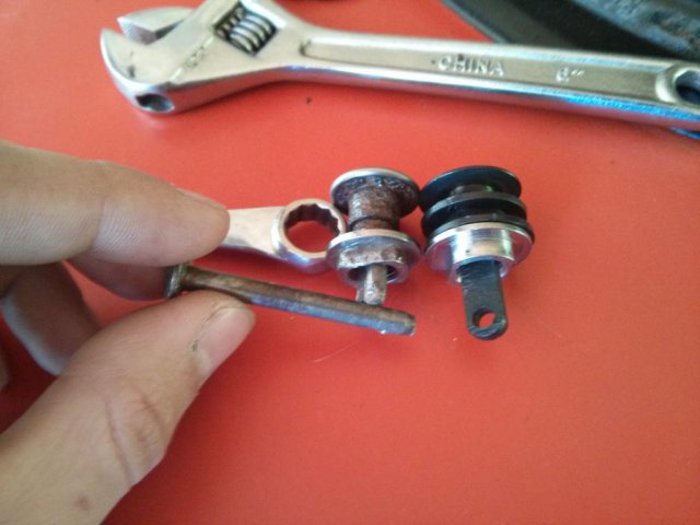

	Woot I got the sunroof latch in the mail today its not an exact match but it was soooo close the id of the retaining pin hole was smaller than what I had so I used the pin that came with the new latch and used my old plastic piece so it matched I just needed the pin that went through the glass :)

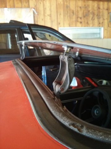

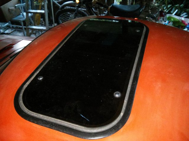

	Call me crazy but I really love this sunroof. It suits the car its been there for every mile on the odometer. Does anyone have any ideas on how to make a new seal or repair this one if a nos piece can not be found? I was thinking if I remove the frame and seal it then I have my mold...

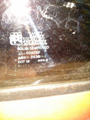

	Looking for help with this old sunroof on my 78. Glass 33.5 x 15.5in rounded rectangle tinted says solar cool on center back. It is pop up style with two back pop up latches and two forward hinges. I think it was a dealer option... I ordered a latch that looks like it may fit on eBay but I still need a seal. If I can't figure it out plan B will involve a rubber mold plan C I suppose is finding some metal and a new headliner
