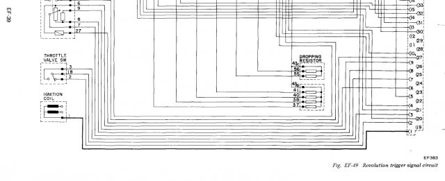

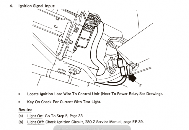

  22. Spark is good, confirmed multiple times. It turns over like normal just with no start, You can smell gas and it will sputter if you hold the gas all the way and try to start. But not run. I did the Third tap test on the connector next to the ecu and it tested positive and I tested that circuit for continuity between the connector and coil and it passed.
  23. Man, I was hoping that someone else made the mistake I did and could help.. I finally had time to further try to diagnose my car today. The ignition Circuit I needed to test runs between the ECU, Coil, Tach, speedo, and what used to be the ignition module. It tested fine so I moved on. Went through the EFI Bible troubleshooting. Nothing tested bad and I moved to the Components check.. Ecu tested good with test light on injectors, Brighter when the temp sensor unplugged. AFM tested good except that Pins 6-8 showed 220homs instead of the factory 180 and the 8-9 pin tested 125 instead of the 100 factory. (EF51) Potentiometer and air temp sensor tested well. Relay switch tested good. Injectors are good. Water temp sensor is new. I did not get a chance to test the dropping resistors, but shouldn't have that shown when I tested the ECU from the injector plug? Does anyone have any ideas why this car wont run? Everything seems to be checking out. I have fuel and spark, actually, alot of fuel. Plugs are saturated. Any ideas?

  25. I made the mistake of welding on the car without first disconnecting the battery and in tuen now have a car that does not start. I still have spark and fuel but it seems the EFI is not working.. Going through the Troubleshooting in the EFI bible I come across this step, I test and my test light does not light so i go to page EF39 of the FSM and get this diagram, And I cannot figure out how to test this circuit. Any one have any advice or can help me? Thanks in advance.
