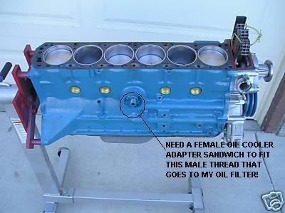

  18. I need a oil cooler adapter sandwich with a female threading to screw into the male threading comming out of the block.. I cant seem to find one anywhere, I have 2 of the male threaded sandwich adapters but as you can see in the picture it doesnt help.. any websites or places or do they even make it for this engine?? Im not sure what to exactly say when I ask for it either.. thanks for the help Ill keep searching.
  19. Okay, so as you can see in the picture. my block looks like that (the oil filter part) IS MALE COMMING OUT OF THE BLOCK Now, I have 2 oil filter adapter sandwichs BUT THERE BOTH MALE THREADED GOING INTO THE BLOCK DOES ANYONE HAVE A FEMALE SIDE THAT SCREWS INTO THE BLOCK THAT WILL FIT ONTO THE BLOCK IN THE PICTURE? Or WHERE TO ORDER ONE? I NEED TO ORDER IT RIGHT NOW ASAP!!! Please let me know! kink15@hotmail.com THANKS!

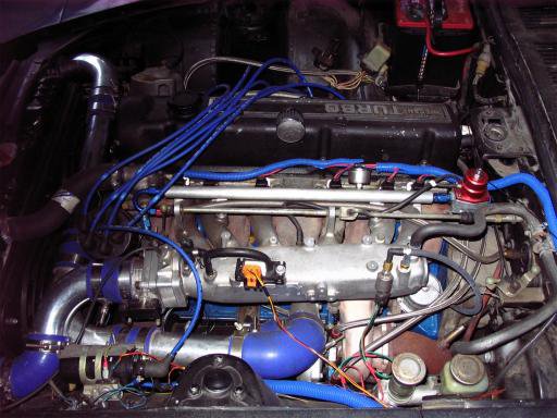

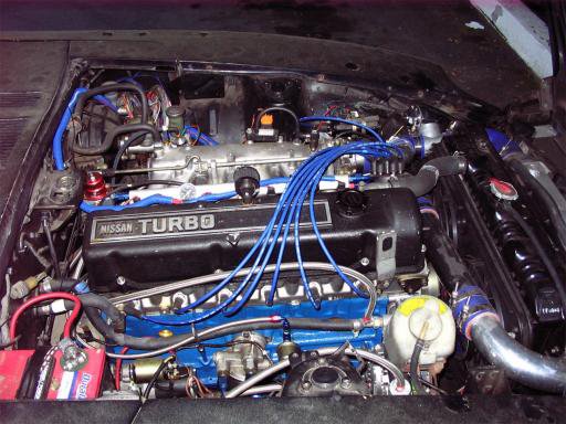

  20. Engine Upgrades: 76 280z w/ 82 280zx p90head with NA Cam 75 280z n42 short block .30 bore ARP Rod Bolts ARP Head Studs 76 Intake with 60mm Throttle Body Rx7 550 Injectors Rx7 Oil Cooler 24x12x3 Intercooler 2.5" Intercooler Piping HKS Blow-off Valve Haltech E11-V2 With flying lead harness Palnet Fuel Rail with Fuel Gauge Tial Wastegate w/17 PSI Spring. GT30R Ball Bearing Turbo DynoMax 2.5 Welded Exhaust Dual Electronic Fan from Summit 82 Maxima Alternator Zeitronics Wideband with EGT sensor Walbro Fuel Pump K&N Air Filter Stainless Steel Lines CenterForce Clutch HKS Turbo Timer Boost Controller ((*trying to decide between msd6a an lsx coils*)) so that would be involved! Drive Train: 240SX 5 Speed Transmission B&M Shift Kit (Sport Short Shifter) 3.9 Rear End Spicer U Joints in Driveshaft and Half Shafts Brakes: Toyota S13 Calipers in Front Drilled Rotors Stainless Steel Brake Lines ZX Brake Booster Suspension: Tokico Illuminas 5 Way Adjustable Shocks Tokico Reds 5 Way Adjustable Springs Poly-Bushings all the way around MSA-Sway Bars
