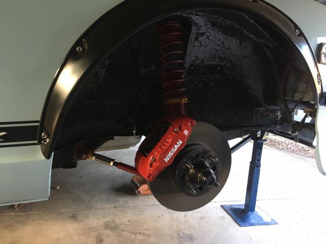

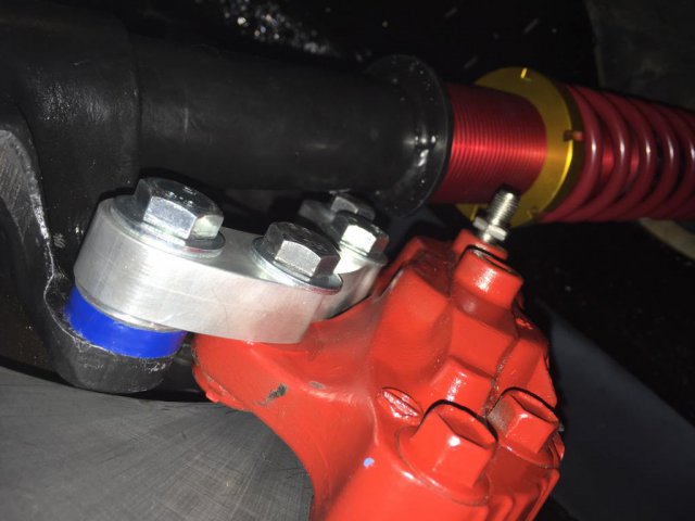

  6. I just competed this conversion on my 260Z with these brackets and oddly found that I actually needed to add 7mm of spacing between the bracket and the strut to centre the caliper on the rotor. See pic (spacer is blue). Not a big deal and all is now good, but just interesting that this has not been described by anyone above. I just thought I should mention it here in case anyone else encounters this. It is probably the rotor hat thickness as the rotor seems to be very close to the strut.
