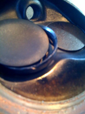

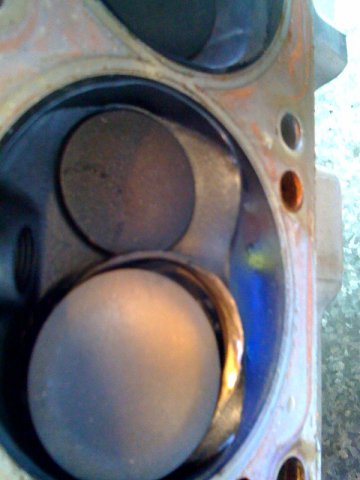

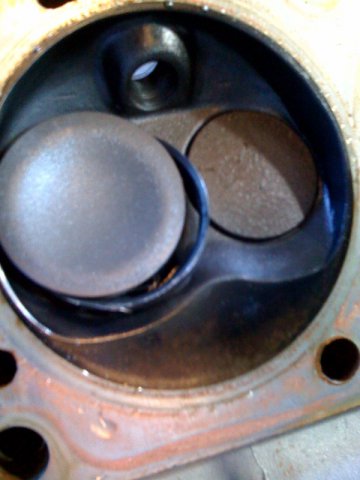

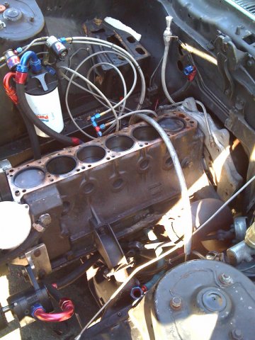

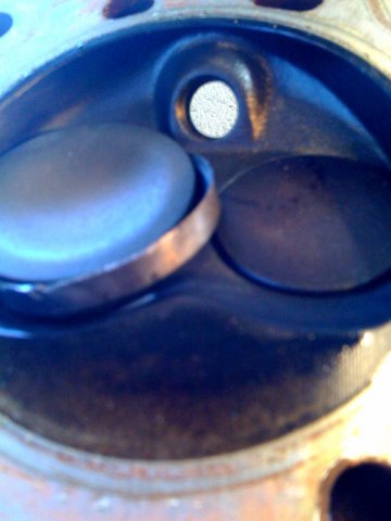

You are correct, dropped it off today at the machinist and preliminary diagnosis is that it was not installed properly. Having the entire head gone through...obviously. I'm going to pull the bottom end and go through it also (#5 rod bearing probably took a beating) and then will start playing again. Cleve -

Maybe the valve bent and then when it returned to the seat it caused the seat to become dislodged due to uneven strike? Cleve -

Pulled the head before all of these shenanigans to fix some leaks and everything "looked" normal...not sure if you can tell when a valve seat is going to let loose. Cleve -

First I did a quick compression test and determined that #5 had ZERO compression which meant either the piston went bye bye or a valve must be stuck open. I determined that I bent a valve by removing the valve cover and observing that the #5 intake valve lash pad was missing and the #5 valve spring was compressed with no pressure from the corresponding rocker arm...valve was bent in the open position and could not return to closed position...I do know a little bit about engines Were you trying as usual to be a prick with this question? Cleve -
