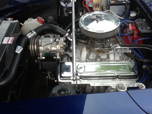

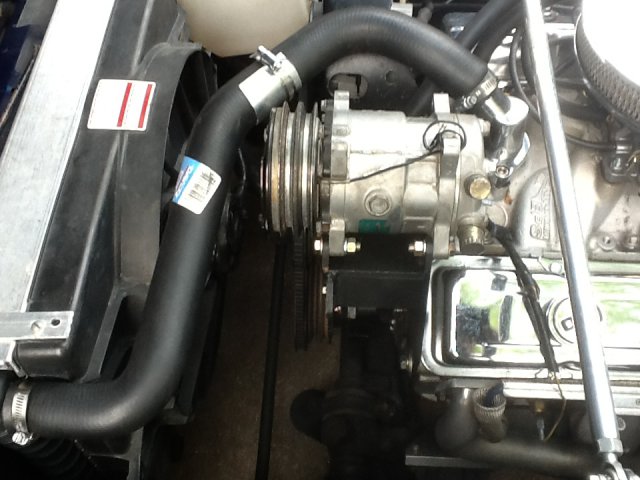

  2. I had to have custom lines made anyway, so I just have them running from the original 626 condenser locations. I modified the stock Mazda upper brackets, cut the legs off the condenser, mounted a couple rubber pads, and made a couple retaining brackets for the bottom.

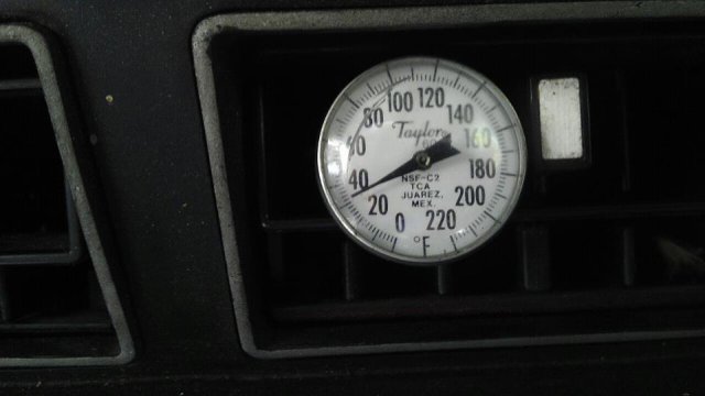

  3. I spent the past couple days installing my Sanden compressor, mazda 626 condenser and drier in my '75 V8Z. I had a hard time finding the o-rings for the expansion valve. For anyone who needs these o-rings, the ID is 38mm and the width is 2mm. After charging the system I am VERY pleased.

  6. I just finished bolting up my Sanden compressor today. I wanted it mounted on the driver's side but did not want it outside the valve cover. I was lucky and found the compressor and bracket on a Dodge truck at Pull-A-Part. It appears that someone started adding A/C to the truck and then abandoned the project. There was also a new condenser and both the condenser and compressor still had the factory caps on them.
