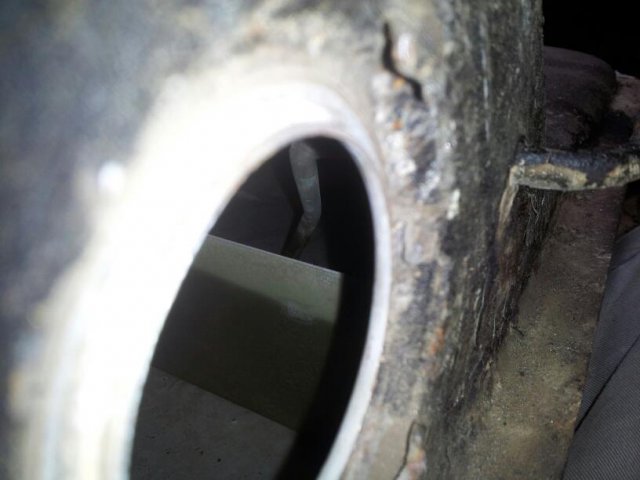

Fuel line "OUT" from tank, noise and vibration
tommott77 replied to str8pipez's topic in Fuel Delivery

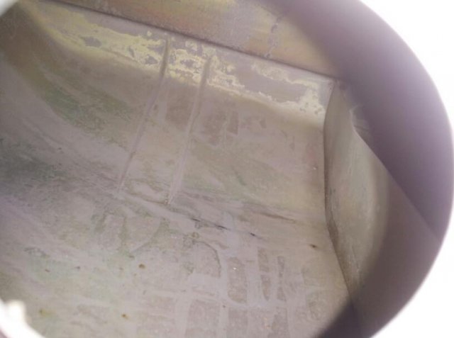

Figured I'd try to piggy-back on this thread before starting a new one since I've been having similar issues. Quick recap. My car too has seemed to have been starving out of fuel with fuel still in the tank. It has no effect on running, one minute it is running the next minute it's off and out of fuel. In all honesty it has been somewhat difficult to track fuel usage as the gauge is inoperable and the car quite a bit of project. Hence it will be on the street for a couple weeks and then off again for a month or longer. In some of the notes that came with the car a previous owner also mentioned that he was having the same issue when the gauge was operable and he stated that the car would starve out with about a 1/2 tank reading on the gauge. There was a leak evident after topping off the tank which I though could be the culprit, but as I was pulling I found that that leak was emanating from a connection on a vent line at the very top of the tank, and was only leaking when the tank was overfilled. My second guess was that the pickup line in the tank may have rotted out, as this seems to be common issue with these cars. I just got the tank all the way out and some pics of the line in question and the innards of the tank itself are posted below. From my vantage point the pickup line looks more or less solid, though my view is somewhat compromised by the baffle in the tank. The tank itself also looks fairly clean. Not sure where to go at this point and am turning to the experts for guidance. Should I check to see if the are any other leaks in the tank itself? The exterior of the tank is quite rusty. If so how is the best approach at doing so; is it ok to put water in the tank? Or should I take the tank to a radiator shop even though it looks clean and everything appears to be in order in there. Perhaps somebody can pick something up from the pics that I missed. -
Have a bit of an issue with fuel starvation with my '73 Z. The car is an older (done more than 20 years ago) 350 sbc swap, so we aren't talking about gobs of fuel pressure here. The car seems to be starving out of fuel before the tank empties. The car starved out yesterday (have a clear fuel filter before the carb which wasn't showing any fuel) and I put a couple of gallons in there and it seemed to be back to normal. I thought it was a bit odd as I had put in a good bit of fuel a month ago last time I drove it. Today I ran it a couple more miles (maybe 10 total miles max since putting 3 gallons in it yesterday) and the car stalled out again, thankfully while pulling out into my driveway. Checked the filter and again it wasn't showing any fuel. Note the the fuel gauge is currently inoperable, but after sticking some PEX piping down the filler tube there definitely is some fuel in the tank. At the very least enough to get me down the road if not substantially more. At first I thought I may have a tank issue or perhaps a leak. I did notice a leak once when I overfilled filling up that I attributed to some bad vent lines or perhaps the filler tube. Now seeing that there is indeed fuel in the tank I may be leaning towards a weak fuel pump on the motor. When I got the car there was some hand written notes that have been passed down from owner to owner over the years and one of the notes, which dates back quite some time, which indicated that the car has run out of fuel once it gets below a half a tank in the past. My question is should I start with the fuel pump which would be a trial and error proposition as the current pump is now functional but may struggle some as the fuel level drops, or should I go ahead and pull the tank out and go through everything on that side of the equation including the sending unit? Another option would be to add another electric fuel pump in line somewhere, though that may be overkill. I seem to recollect that stock Zs ran off an electric fuel pump, I don't see one still installed on the car anywhere. Any advice here would be greatly appreciated.

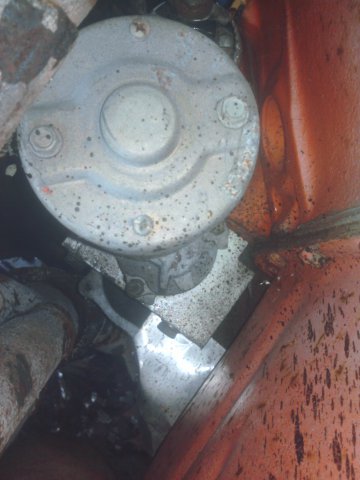

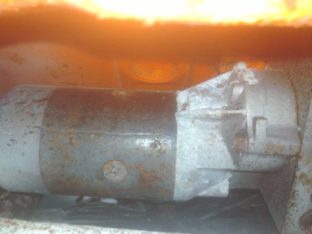

First I wanted to thanks everybody for the help. Got the correct starter and got her installed. Still having problems though and would like to see if anybody could get me pointed in the right direction. The car still does not start sometimes, both when cold and warm. Car now obviously has a new starter (high torque), and a new Optima battery with 980 CCA. The issue seems to be completely random, and it either turns over as normal or you just hear the solenoid click, all or nothing and you never hear the starter struggle to turn. Whenever the issue arises typically I just through on a battery box and it starts right up, however today the battery box did not work and I had to leave the car over at my buddy's shop. The battery seems to be holding charge, and the alternator is charging. Cleaned the grounds. Any ideas?
I purchased a '73 Z with a pre-swapped Nordskog small block chevy V8. She's a bit of a project and even after changing batteries she is still a bit of bear to get started. Contacted the previous owner and he said that he felt that the starter was on the way out when he put the car in storage about 6 years ago. This is my first sbc experience. After doing some research and searching on this site it appears that some starters work with different flywheels (based off of tooth count) and some have different a bolt pattern. Unsure if these are two factors are mutually exclusive or not. Also not sure which flywheel is in the car. I was wondering if anybody could help identify which starter I need based off some pictures I took (see below) with the starter still in the car?

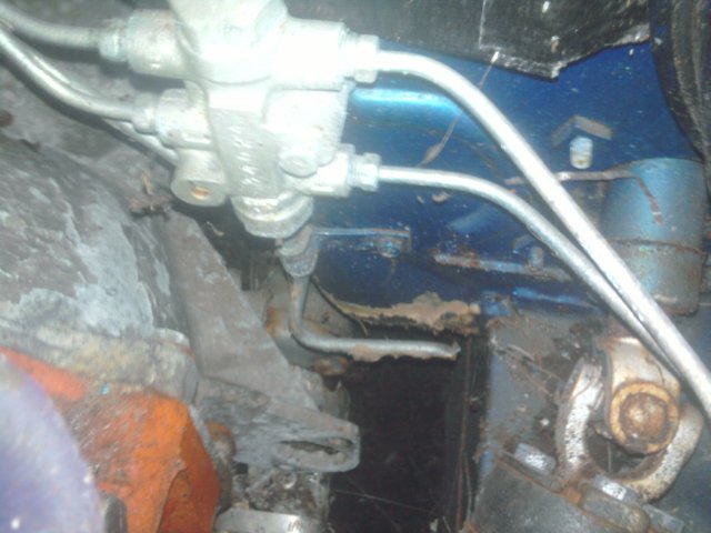

There is one melted slave cylinder in the trunk of the car. Undoubtedly a casualty of the pyrotechnic exhaust system. The seller confirmed that the line is indeed plugged, but didn't say what it used to be. I would have to say that it is some sort of brake line seeing that it runs parallel to the current rear brake line. The only thing I can think of is that somebody re-ran the rear brake line, but for some reason kept the old line in there.

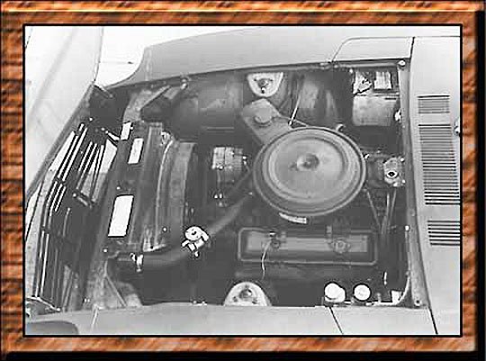

That's odd that the ebay link is already dead. Perhaps this works....... http://cgi.ebay.com/ebaymotors/1973-240Z-probuilt-350-chevy-400-plus-HP-5spd-lim-slp-R-/360376637867?pt=US_Cars_Trucks&hash=item53e81f19ab Anybody able to tell anything by comparing the picture of the engine bay in the ebay listing to the attached JTR picture? The hood latch on my car appears to be stock, but to my layman eye it seems that both motors line up with the strut towers about equally. Not sure if you can fit a strut brace on a kit that has the motor too far forward.
