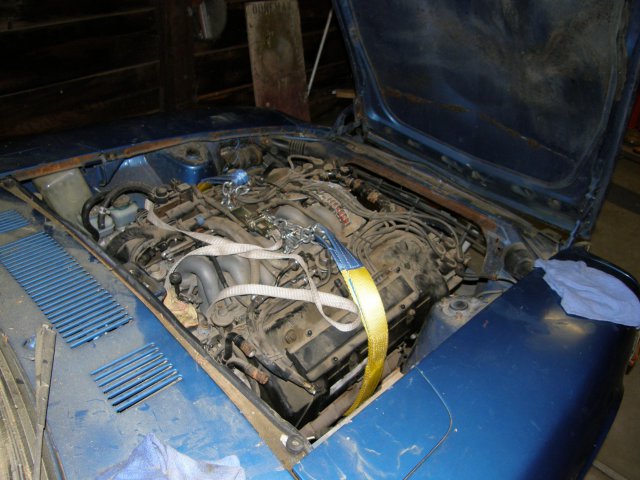

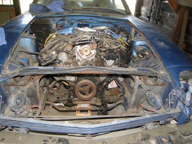

  7. The fit is close less then 2 inches on each side when centered and is very tall with about 1/2" between the hood and the front top metal water tube with the engine resting on the cross member (that should be better when the oil filter adapter is in place) . The 5.4 will be obviously even tighter.

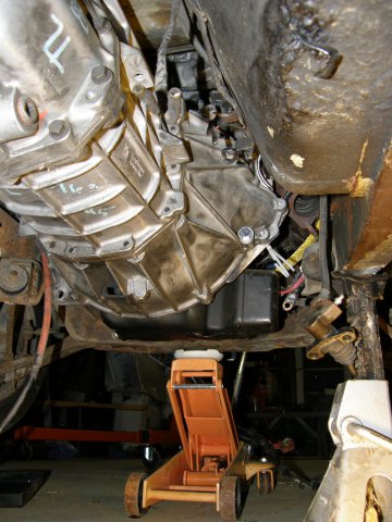

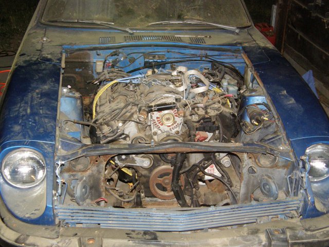

  8. I got the engine out of the u pull it yard for $165 plus tax, out of a mark 1993 viii lincoln with 128k miles on it. I have a t45 from craigslist for $50 (the guy had it rebuilt but the shop forgot to put oil back in it). It should be just fine for fitment purposes. The 260z I got off craigslist for $80, no engine, no transmision, no title, rusty but most of it is superficial. It took me a while to get the title reinstated. There are other issues holding me back... like my shop is an old corral that is falling apart. But I have managed to get an initial fit. The main problems are the exhaust vs steering shaft and the oil filter and pressure sending unit vs the steering rack. It looks like the remote oil change kits will solve that. The hood latch will have to be relocated. etc etc etc. Here are some pics of the first fesiblity fit.
