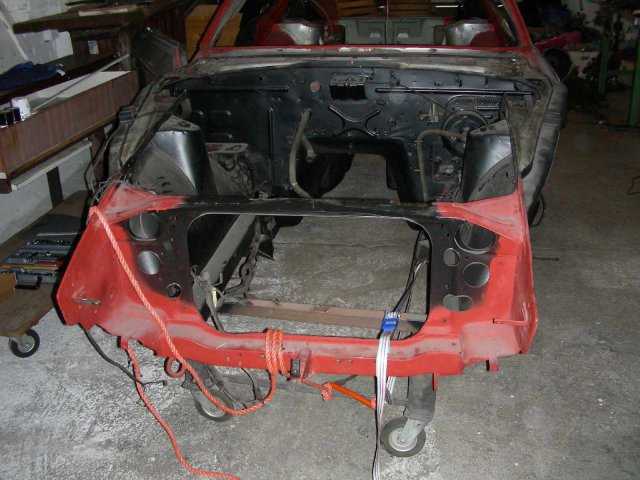

The whole project is still on hold because I cant find parts like the inner fender to do the repair as you can see. This work would never pass the government inspection. The crazy thing is I could find a rolling chassis, but the transport to europe is around 4500$. I'm still hoping to find basicly the whole front to exchange everything.

I started to rebuild my 1972 240z. The body was badly done 15 years ago. I need a good 240z body/ rolling chassis without rust. Thanks Marcel

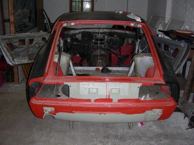

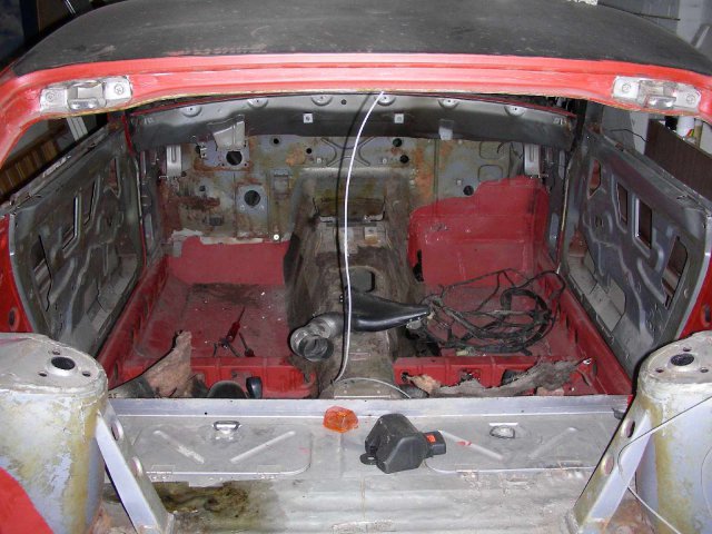

Startet with the underbody and there is a lot of Tectyl (3mm to 5mm.) Heating it up and scraping is a lot of work. The body shop did a really bad job 15 years ago before the body went to sleep till now. Many hidden rosty parts to be repaired again. (Grr paid 10'000 $ at that time for the body shop.) They did a good job at the back but a really bad one in the front. Like two people worked on it. There are up to 3 layers of metal. This time Im going to do it myself. To bad I tought I could go to the bare metal and bring it to the paint shop. So the whole mecanical part of the rebuild is a bit on hold. The list is huge there. roughly 8K$ of parts till now without the engine. I heard already a few times are you out of your mind? maybe I am. But this was my first car. I don't care it's like go back in time. Some people want young GF and I want my first car back

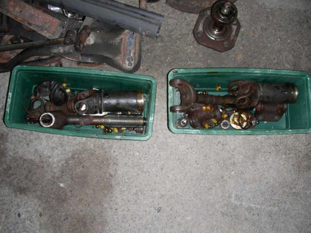

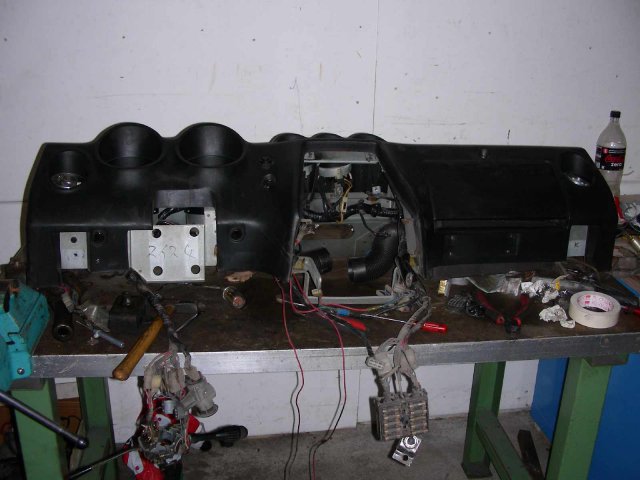

Finally Some Pictures. All the disasemble is done Now the cleaning, aranging and organizing everything starts. Then get down to the bare metal. Started to build a rotisserie with two Motorlifts. will see how this works out.

After another 6 Month of reading and preparation the rebuild finaly started. Disassembled the hole suspension. The first decisions made are Install new Springs From I don't know yet and Illumina Shocks from Tokico Bigger front break kit and Rear Disc conversion and all bushings in urethan. Pictures to come
