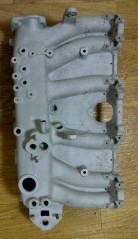

Really great work guys, I'm super excited now about shaving, cutting, welding, and smoothing her down. I prefer the non webbed intakes myself but a lot of cats tell me that the webbed intakes help to avoid the whole "heat soak" issue. Thanks for all the great advice and pics guys.....
Thanks..... So I can eliminate all that stuff and she'll idle just fine and none of it will affect keeping heat in the car..... Excellent......
I realize that I’m about to ask some questions that have been discussed (ad-nauseam) but the specific questions I have havn’t been covered, and if they have I haven’t seen any discussion on them in these forums unless I overlooked them, If I did let me preface my inquiry with an apology. What I specifically want to know is if it’s ok to completely blend all of the offending raised sections & weld shut all offending orifices from the L28 turbo intake manifold and still be able to run heat & regulate the air properly. I don’t care about the emission stuff. If one completely gets rid of all offending holes and raised air regulator connections, how will the manifold regulate the incoming air? I’ve seen these “completely stripped†intakes on turbo models so obviously it can be done. I’m just concerned about the “air regulator†and keeping heat in the car. I’ve attached some pictures of my intake manifold after it was blasted, and I also attached a picture of a turbo intake set up without these objects being lopped off. I also just added pictures of my intake manifold with the areas I want to get rid of circled in red. Thoughts and guidance would be most appreciated. Intake Idea.bmp Intake Idea 2.bmp
Thanks guys, I'll smooth it out and keep on truckin.....

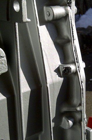

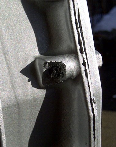

So I blasted my tranny this morning, and then I proceeded to tape it up & paint it. Just as I was feeling really proud of myself, I noticed a slight glitch, a section of material missing on the housing where a pan bolt threads in. I don’t think its cause for major alarm but I took some pictures and posted them for some of you experts to hopefully give me your opinion. What are your thought’s, am I worrying unnecessarily, and if it needs to be fixed, what’s the best way to go about it? As always, thanks in advance.....

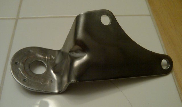

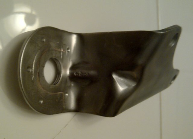

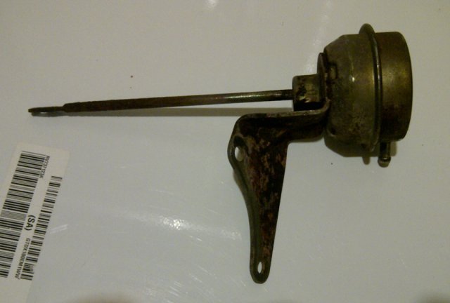

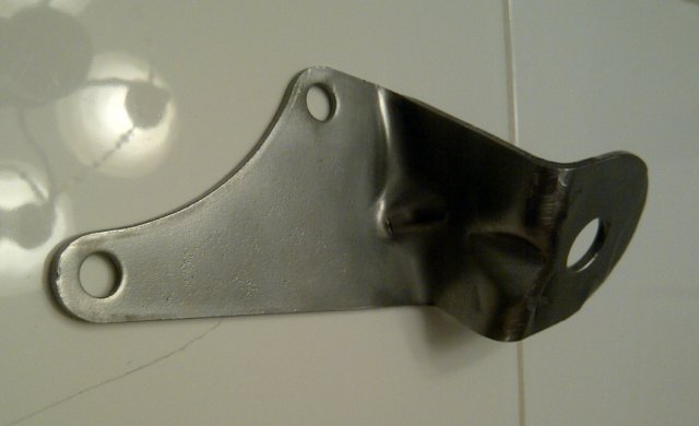

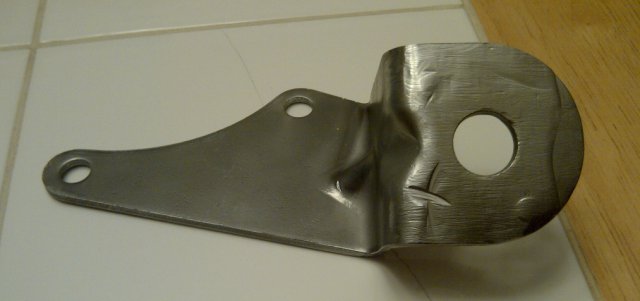

Did the actuator bracket have the correct angle or did you have to position the actuator arm directly over the oil inlet of the center section? I guess you could do that, but I wanted to keep all of the original angles of the original set-up the same. I already had a Dremel, so all I had to do was attach one of those "cutting disc's" to it and cut through the tack welds to get the old actuator housing off, and then I smoothed everything down with a cylindrical sanding disc. Took me all of 30 minutes to do and cost me nothing. Good luck with your set-up………… -

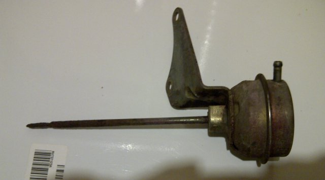

So I searched the internet hi & low and made many phone calls looking for the right bracket that would mount an internal wastegate actuator for my T3, but could'nt find the right bracket with the right angle for a new actuator. In the end I decided to just cut the actuator can off of the original bracket and use it instead of beating my head against an unmoving object. Once I get the new can in, I’ll make the measurements for the mounting bolts, drill the holes, and mount everything. I’ve attached pictures of the old actuator before and after the mod, including the new actuator I plan on purchasing for others going through this. Hopefully it will give some of you some ideas............ Ciao…….

Well my turbo is back together sans the wastegate actuator. I’m going to put a 10psi unit on and I’m going to modify the original bracket by taking off the tack welded can and drilling the holes for the mounting bolts of the new actuator. Why somebody didn’t make a bracket that angles correctly for the T3/T4 models is beyond me. There are several that will fit those particular turbo’s but none of them have the right angle in order for the oil inlet to be properly un-obstructed. I went back and forth and did a ton of research on the “balancing†thing and settled on trying a little experiment first. I fired up my air compressor, cranked the air pressure up well over 100psi, pointed my conned air nozzle at the hot end turbine and spun the hell out of her. She whipped around at lightning speed and didn’t so much as shake, vibrate, or anything. She was as steady as a rock, so needless to say I didn’t feel the need to send those components out to be balanced. Now before I get the avalanche of scolding for my back yard under the shade tree method with the airline. I can’t imagine a bench getting the turbine to spin much faster, and if it were out of balance I would have seen and/or felt it. I felt comfortable enough that I reassembled the whole thing and I’m positive she’ll perform just fine under power. If not – lesson learned and I'll have it professionally balanced. I also have to agree that $500.00 seems like a bit much to rebuild a turbo, especially given the prices of new and good used turbo’s on the market……..

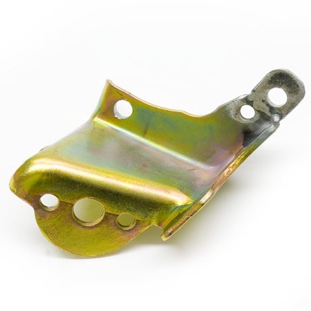

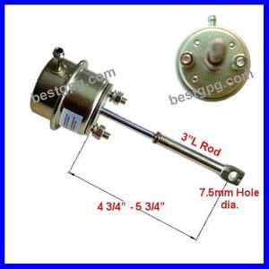

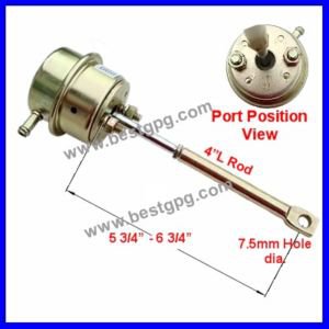

I found the actuator from this web site for $39.00 bucks: http://www00.mailcar.net/catalog/index.php?seller=mpgstore&main_page=product_info&mode=s&schm=1&cLink=c&products_id=380303320381&psemtrk=google&utm_campaign=EcommerceStoreMarketing&utm_source=GoogleBase&utm_medium=GoogleBase&utm_term=GoogleBase I found the bracket from this web site for $29.00 bucks: http://www.atpturbo.com/mm5/merchant.mvc?Screen=PROD&Store_Code=tp&Product_Code=ATP-WGT-011&Category_Code=WGT The actuator I found is also the same one on eBay, I attached some pictures.

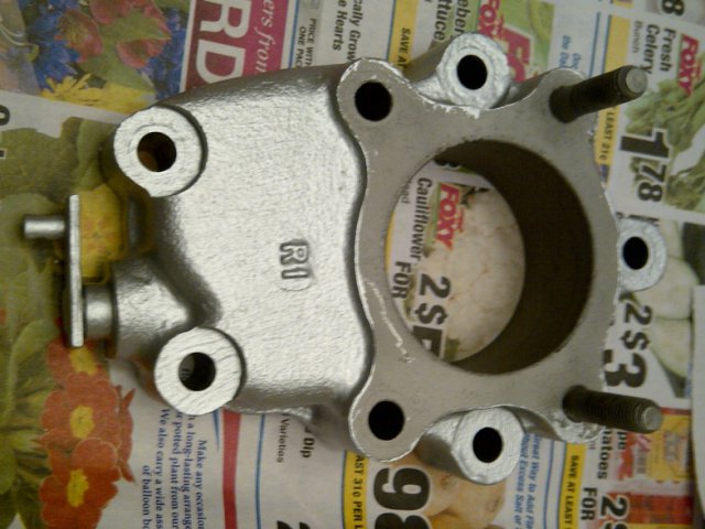

Deaner, I was actually thinking the same thing because I’ve searched the internet, turbo parts suppliers, & eBay high & low and I’m not seeing a gasket (made from any material) that will fit that 7 bolt configuration which seriously leads me to believe there never was one. And if there were gaskets used (back in 1982) there sure as heck aren’t any available now. I’ve mated them in a test fit and the surfaces mate up perfectly with no gaps so I think the high temp orange sealant is a viable option. The biggest take-away I’ve learned from all of this is how important it is to visibly look and check everything before it’s pulled apart. Something I already know, so shame on me. Thanks everybody……….
Thanks Dexter, That actually makes sense because I can't seem to find a gasket anywhere (internet or otherwise) that would fit between the two housings perfectly, and like I said in my original post, I couldn't remember seeing one when I ripped it all apart. When you say (You will need a gasket on the back of that wastegate flapper housing though) you’re talking about the four bolt pattern where the exhaust bolts on right? Serves me right for not paying closer attention…… Thanks for all the help gang...........

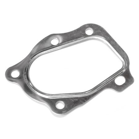

Kaito, It is an original T3 turbo that came with the car and I looked at the metal gasket on eBay from the link you sent me...... But there is a large area of material that would cover the actual internal wastegate if I used this gasket. Would that be correct? Wouldn't the wastegate be blocked if I used this gasket, or I am completely off here? If the one you sent is the one that should be used then I'll definitely get it. I just want to be sure. Thanks for your help.......
Ok Gang, All of the parts for my turbo rebuild have been procured and even painted with POR 20. I’m at the stage where everything is ready to be bolted back together but I have a dilemma. I don’t remember there being a metal gasket between the "7 bolt" turbo housing and the "7 bolt†internal wastegate exhaust section. I’ve looked all over the internet and all I see are “5 bolt†metal gaskets but not 7 bolt metal gaskets. Were their no gaskets that went between these two sections or am I just not looking in the right places? I’ve attached pictures so you all can see exactly which two parts I’m talking about including a picture of a 5 bolt gasket. As Always, Thanks…………

So I saw all the Garrett T3 turbo wastegate actuators on eBay and I’ve been all over the various turbo rebuild web sites and I haven’t seen anything that resembles or comes close to the stock wastegate actuator that came off of my original turbo set up. I’ve combed over the posts in here and haven’t seen anything on where one would go to source one. Do any of you know where I could source an actuator that will bolt right onto the turbo or are there any other aftermarket ones that will work with the original set up? I've attached pictures of mine for reference. Thanks in advance gang……..
