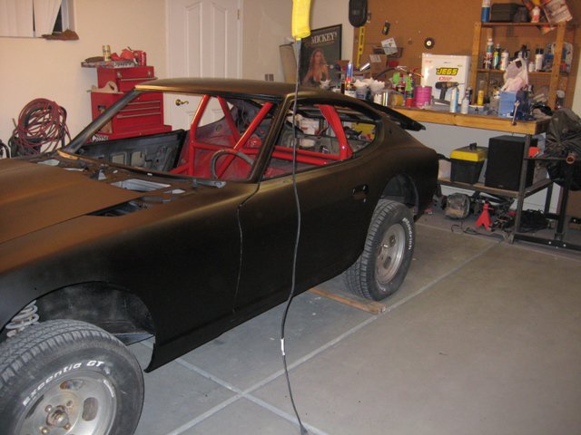

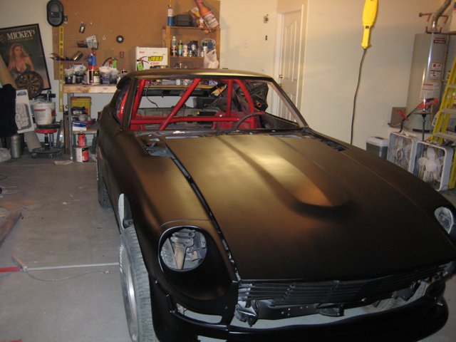

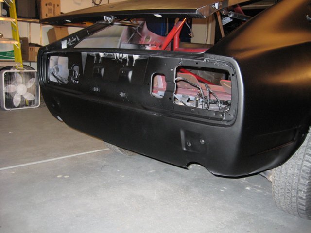

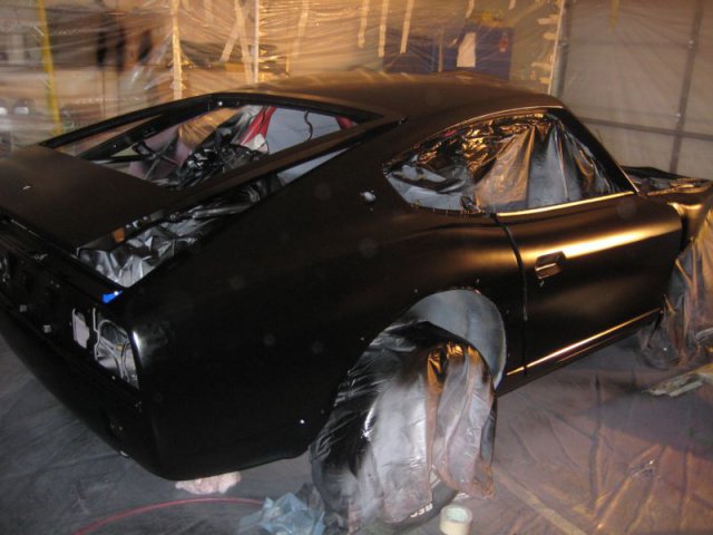

  12. I didn't have heat lamps but I had 1000w flood lights but it was a nice 70 in my garage. the day I picked to paint was the first day it rained in arizona for like a year. slight orange peel, I didn't buff it, was thinking about wet sanding the whole thing but haven't as for dry time I was able to touch it at like 20- 30 minutes Dust was a factor I had two floor box fans that I put AC fliters over to move air that helped but still had some dust

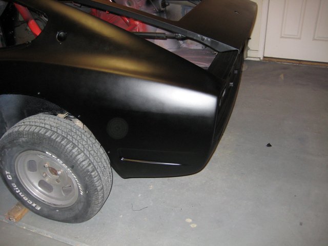

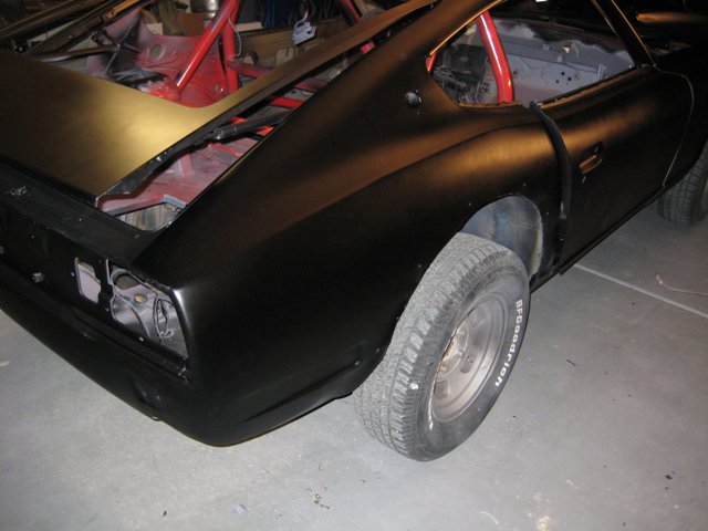

  13. Well to me it seemed to lay down nice. To me it seemed the dupont primer was alot easier to spray. Keep in mind I have no experience in auto paint, I literally just mixed it up, put it in the cheap $90.00 3 piece hvlp gun set and sprayed lol. The pattern was a nice cigar shape, so I left it. I didn't mess with any of the fluid control or air control knobs. The paint directions said to use 2 coats but I didn't have good coverage with 2 so I did 3. Other then some flaws like runs and particulates it looks good enough for me. I fell if I would of had a real booth with enough room and good lighting I could of done a better job. If I wanted to have a show car I would of paid someone else lol
  14. Its supposed to be flat, and it actually is flat in person but for some reason the camera and poor lighting make it a lil glossy
  15. This is my first time doing anything paint and bodywork related so I'm quite please with how it turned out
  16. Thats a good idea I'll wet sand everything with 800 grit the go over it with another coat, i'll just a lil more reducer. I think it looks good and my body work turned out better then I thought lol. But I guess only a mother could love a ugly child. I'll post pics first thing tomorrow when I get home
