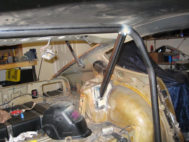

  5. I am really happy with how mine turned out. As a novice weldor it was hard to weld all the way around I had to make some blind welds. But I think I did pretty darn good. My car was stripped with all the windows out. And I didn't have a notcher so I spent hours upon hours grinding notches. Not fun
  6. Nothing is wrong with it. It just requires work to make it look good. And after you make the bends, trust me you'll want to bend the door bars, you'll be thinking that was easy. I should of just bought the metal and bent it myself and have a tight fitting custom cage.if of course you have access to a good tube bender. The jegs hoop is a good fit but I feel I could of made it tighter. Just my opinion.

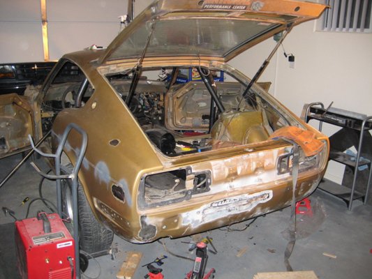

  7. I installed a Jegs 8 point and copied 240hoke, so pretty much all that was used was the main hoop the rest custom bent and notched. If I had to do it over again I would of bought a roll cage bender and did it myself.. A few pics just one more piece to notch and i'm finished.

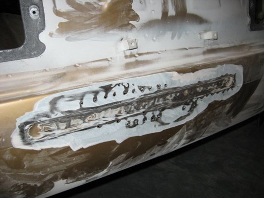

  11. While in the process of shaving my 260z rear. I find this and the filler is thick looks like the p.o. backed into something hard. I just have to vent... looks like more body work then I had planned for.
