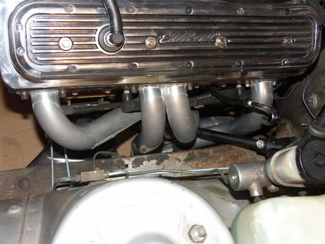

I completed the sbc conversion in my 83 ZXT. I originally had power rack steering but had to give it up in favor of the manual rack to allow the headers to free flow on the driver side. There may have been a better solution, which I lament bcause I do miss the power steering. If you can find a way to fabricate the headers around that steering assembly in the 83 model you will be among the few. Here are a few pics from a few angles of how we ran the steering rod. DanJ -

I have a 383 SBC in my 83ZXT. Clearing the steering hardware was a real issue on running the full-flow headers. I ended up having to convert to a manual rack steering and give up the A/C system. If you have the power rack it is nice to try to salvage that if you can. Driveability really changes, especially at low traffic speeds, when you give up the power rack. I had a speed shop assist with the conversion so I'm not sure how hard they tried to work around the problem. We didn't consider the JTR headers at the time. It might be best to locate someone that has actually installed the JTR header on the driver's side in the ZX and see what issues they still had to overcome. I know on my conversion it was the biggest hurdle in the fabrication. You can see from the attached photo how the steering rod was custom-fitted through the fabricated headers. DanJ
