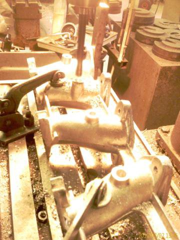

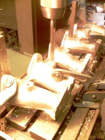

	Here is a little update, bungs have been milled, drilled and tapped, sorry for the crappy phone pics. Chris
