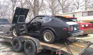

Last year (May 2011) I bought a 280z out of shed in Lakeville after looking at various Z's mostly for fun in the metro area -- this one hadn't been running in 7 or so years but the body was clean and my neighbor car-guru thought it was a solid deal at $1500. 119k miles, 5 speed, black coupe with black interior. The paint was crap so a respray was a must -- different sections of the car had different shades of black, some matte, others glossy...I'm still confused how this happened (no owner history) and it came with black paint, which wasn't even offered in 1978. My dad's original intentions were to 'refresh' the car and then just have fun driving it; I wanted to do a lot more with it (engine swap) but my plans have since changed. The engine turned over with starter fluid but the body was clean (I had read about the horrible rust issues on Z's), so I bought it and had it delivered to my house the following week.

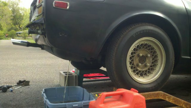

After getting the Z, the first order of business was to get the engine running. A new battery fixed the intermittent starter motor but it didn't seem to be getting gas, so I pulled all the injectors (several bolts broke off...) and stuck new ones on. Still no luck, although there was gas in the lines. A new fuel pump went in and after an inspection of other fuel components; that got the engine running, but not for long. It wouldn't idle and stepping on the gas too hard would kill it. After several weeks of slowly finding time to work on it, we (my neighbor, dad and I) found the issue was a leaky AFM rubber pipe. After replacing that, the engine idled great. Next step was to get a radiator fan because it didn't come with one. I ordered a water pump pulley and had a fan from some other car lying around, so I ground it down to clear the water pump bolts and that fit very nicely. The engine ran well and driving it was a blast, so our cheap barn find felt like a solid buy.
I stripped out the ratty old interior carpet expecting to find rusted out floorboards, but to my surprise they were in great shape, like the rest of the car. The only real rust issues were through the front right wheel well and frame rails, the other rust was cosmetic and will be sorted out when it gets painted. We had a family friend welder weld Mad Dog frame rails on to ensure a solid frame and patched the major rust spot. We bled the brakes, but they still aren't that great and I would like to go discs all around. My dad wanted new carpet for the interior (priorities..?) so I bought and installed it. Also bought windshield wiper arms aftermarket mirrors to make it legal. I took the front and rear bumpers off because those steel anchors do not belong on a Z. The gas gauge didn't work so I pulled the tank and de-rusted the sending unit, which fixed that problem -- soon I will clean and coat the inside of the gas tank because it is quite rusty.
