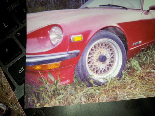

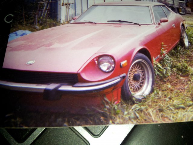

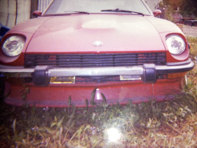

  19. black dragon automotive $80 for z $50 for zx less shipping pt#80-722
  20. No succsess, I could not find anything using google or bing search regarding z car other than an intresting epa article stating the air dam is aerodynamicly sound and lowers the mpg. did find 75-78 kamei air dam on ebay but looks completly different so i now have my suspensions as to this air dam being a Kamei, but not throwing it out just yet will you please send the links where you seen it. thanks I also resized the pics for everybody
  21. I really appreciate the info I new it was pretty rare now that I know the name of it I can do some searching on it if I still can't find it I may ask for the links but shouldn't be necessary I think I may buy several of them for hoarding purposes lo,l what do you think of the style.
