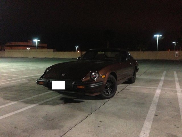

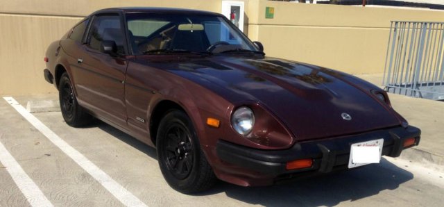

	Any chance we could see a picture from the back of the car? I'm wondering how wide the wheels look on the car. You gonna go any lower haha? Car looks rad though! I like that front airdam, I need to get one soon but I can't find anyone selling one used. I agree with getting some spacers to push the wheel out, that'd make it look nice.
