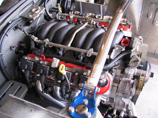

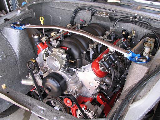

  2. The LS_1 is in and running in my 1978 280Z. I received the JTR (Stealth) radiator today and have it mounted in the Z. Brackets provided worked well and everything fit as hoped. NOW the hard part. Does anyone have any information on what hoses to use. I have the T and reducer that was provided by JTR, but no clue on where to begin with the hoses. Any information would helpful !!!! Thanks in advance

  8. Thanks for the compliment Mexicola. I stripped the compartment to bare metal. The painted it with Eastwood Rust Encapsulator. After that I used Eastwood trunk paint followed with 5 coats of Eastwood clear Diamond coat. I wanted the finish to be forgiving, and so far it has worked.
