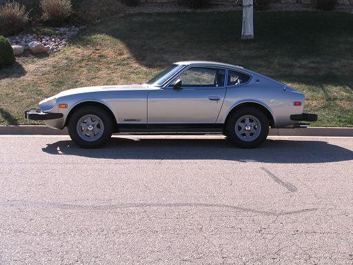

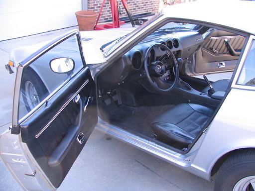

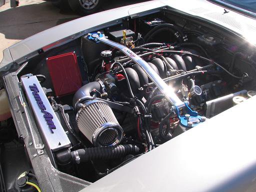

The project is finally finished. The engine is in and runs strong !!! The paint turned out great and the car is back together. The journey began July 28, 2007 and ended April 22, 2008. That is if it ever ends. Some minor adjustments to go. Thanks to everyone that helped over the last year. Hybrid Z and its members are the best !!! P.S. I got another 280Z, may do it again !!!

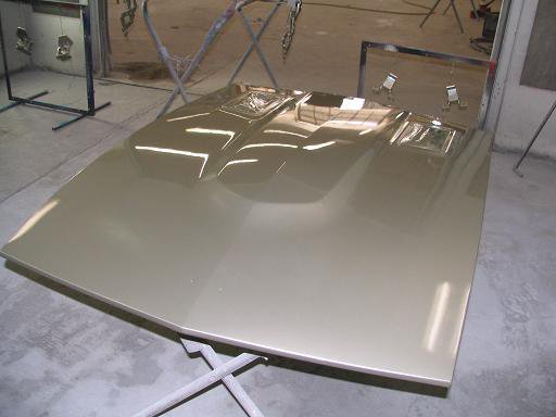

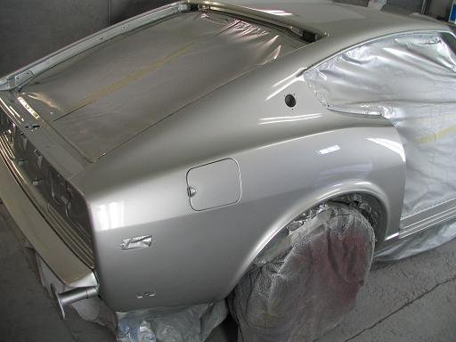

Thanks for the compliment. I used Eastwood trunk paint black/grey and put three coats of Easwood diamond clear over it for protection. It seals it as the base coat is not water proof.

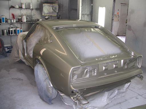

I dont have the paint code, will ask the painter. It is the original color, metallic silver. He did put three coats of clear coat on it. He said the paint code is still carried over, so original color, latest technology paint. I am susposed to pick it up today. Then its put the bumpers etc back on. Thanks for the comments !! The color is slightly lighter than the pics, must be the lights. -

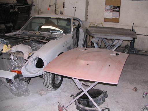

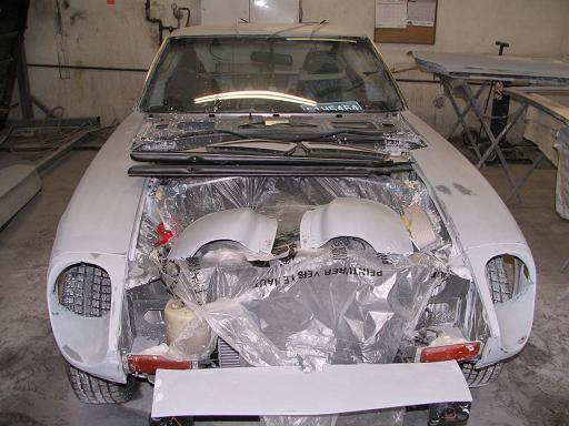

I have not posted in a while. The LS1 conversion is complete, and the car is in the paint shop for a redo. We are in the third week of the makeover, about one more week to go. Car was stripped down, block sanded, epoxy primered, painted and clear coated. Now it wil be sanded again and polished. The shop mostly does old rods and muslcle cars, doesn't do to many cars as "NEW" as my 1978. Exterior will be all original, including color. Hope you like the pictures

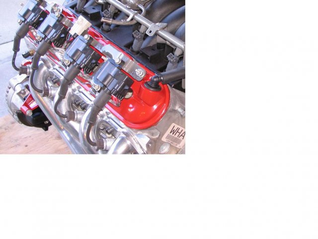

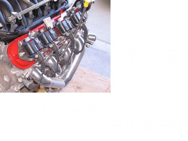

My Pontiac Trans Am LS_1 wires are still on with JTR (Sanderson) headers. They came with the metal heat shield. Only one on the passenger side looks a little close to the tubes. -

Stick with what works. Go to JTR and order the Sanderson ceramic coated headers. The are top notch, but mor importantly they fit with the engine in the car without any cutting or grinding. Put them on my 1978 Datsun 280Z with a Pontiac Trans Am LS_1 with 6 speed.
