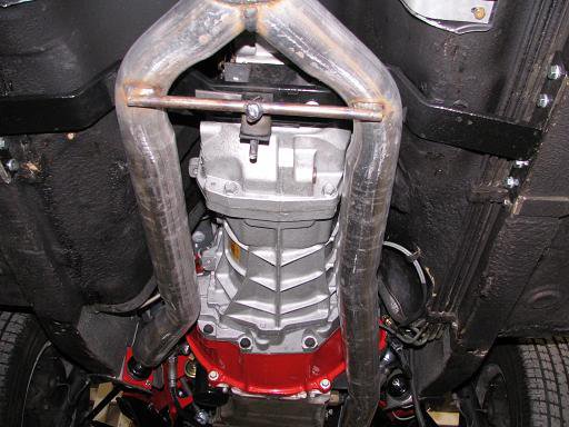

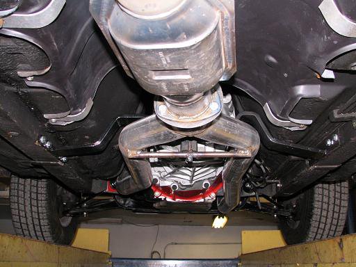

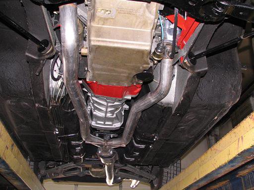

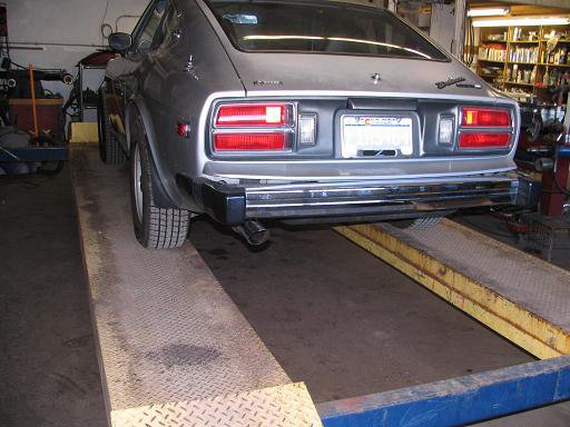

They come off the collectors at 21/2" merge into a 3" CAT and run 3" the rest of the way.

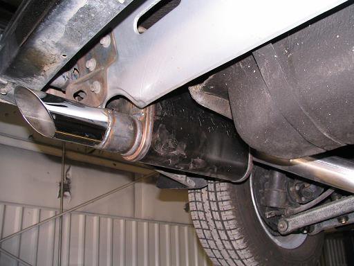

It is a magnaflow - thats all I know

The large heat shield came with the car new. I bought it in California in 1978, it required a CAT and the heatshield. I hope it keeps the car temp down as i imagine the LS_1 puts out a lot of heat. I am amazed you picked up on it. I am trying to upload to you tube so you can hear it running

Just brought the car home from the muffler shop. I was able to find a real craftsman to do it. I hope you agree. Now its time to put the body together and get it painted. I am amazed at how smooth the car is, its power, its drivability and the help from this web site. I have driven this car for over 30 years, only put 58,000 miles on it and was concerned I was going to ruin a classic. But the LS_1 along with John's Cars Kit and other parts from JTR make this a better car and and I think my Z understands that!!!! http://www.cardomain.com/ride/2282022

http://www.cardomain.com/ride/2282022 My exhaust is not complete yet. Plan on the two headers going into one 3" cat and a 3" pipe out the back thru a magna flow muffler. The canister has three hoses. One for vacuum, hooked to nipple on air intake, one from tank to canister, and one from canister to engine. I t-eed into the line from the P/S valve cover that runs into the air intake. Good luck. -
