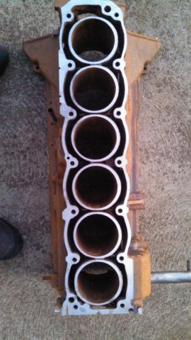

My engine builder had a F54 block with a crack in the deck along its length that was un-repairable,
so he milled the top of the deck off to see where the bore core shift was. Notice how non-concentric the bore castings are - this make sonic testing and off-set boring a must!
Were the bores Sonic tested before it was bored? Or were you just a cowboy and bored it on the original bore centreline?
FWIW I went through 4 blocks - both N42 & F54 - before I found a my current F54 block that could take a 89mm bore safely - while retaining 120 thou wall thickness.
