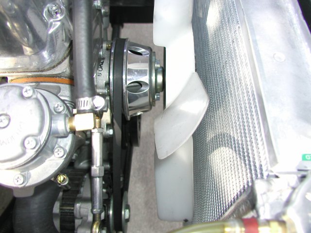

The early Zs had a reputation for overheating. Since this car is to be a daily driver in Florida, steps were taken to resolve this. In addition to the new water pump and fan conversion shown above, the radiator was replaced with the Arizona Z cross-flow aluminum unit. It should be noted that this unit is sized for the larger 280Z, but will bolt into the 240. However, it was found that mounting a fan shroud was not possible, at least not possible without far too much work. The expansion tank mounts to the right shock tower. The MSA oil cooler is also a key part of the cooling plan. It has been mounted on custom brackets. The water tube at the rear of the engine was rusted out, and was replaced with a custom aluminum fabrication. It is powder coated grey. The stock part is no longer available. The car has a 160° thermostat. It has been in the high 80s and low 90s since testing started here in Florida. The water temperature has not moved above 170°.
The engine was pulled during the phase 1 rebuild. It was stripped, and received a coat of blue POR15 engine paint. The aluminum oil pan from Arizona Z was added, along with a new high-output oil pump. All of the externally accessible seals and gaskets were replaced. All of the externally accessible bolts (rods, main caps) were checked for torque. The water pump is new, along with the fan conversion kit to the newer plastic fan, and a set of aluminum pulleys. The harmonic balancer was replaced with a lightweight version. The alternator is the 105A internally regulated unit from Z Specialties. The engine compartment itself was stripped and refinished with POR15 and a UV-proof gloss topcoat. The spreader bar had to be bent slightly in a hydraulic bender to clear the Nissan valve cover.
