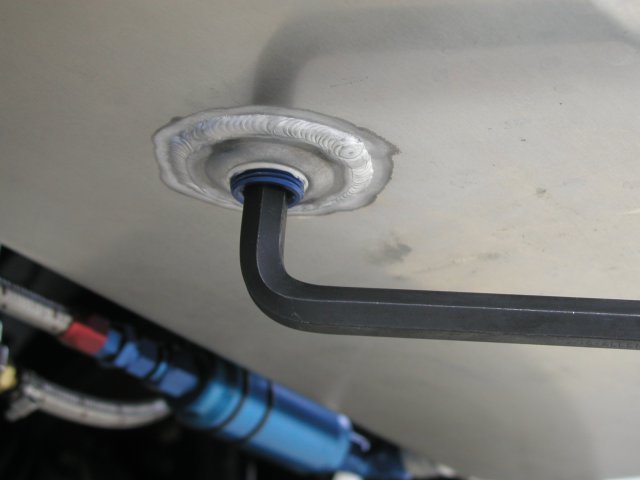

The 9/16" allen wrench finally showed up, so the tank was drained dry and the Earl's 3/4" aluminum plug was installed, replacing a temporary for the tank drain. Since the tank was dry, I used the occasion to find out what it really holds, and to begin calibrating the fuel gauge. Tank Capacity: 15.5 US Gallons, filled to a point 4" below the bottom of the overflow tube in the filler neck. This also coincides with the level of the floorpan under the hatch. I will post the fuel gauge calibration information separately.

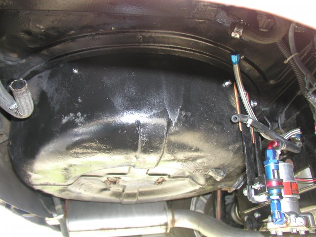

My pump is mounted on brackets attached to the spare tire well. It is directly in line with the filter, and at the same elevation, so it is gravity fed on the inlet at all times. Here's a few pictures of the installation (before the new tank): Rose's Ride, scroll down to post #24. Post #21 shows the brackets before mounting. Naturally, the filter and plumbing have changed a bit with the new tank. I'll take pictures when I finish up. You do make a good point, though. If the pump were mounted to the tank, you could hard pipe it to the filter and outlet, eliminating one soft line.

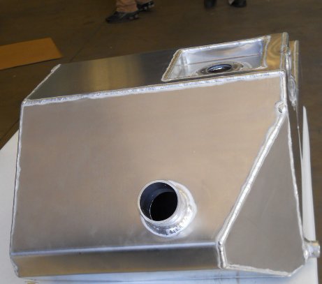

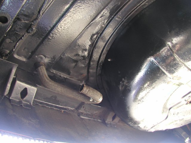

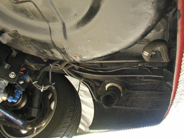

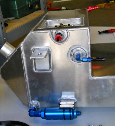

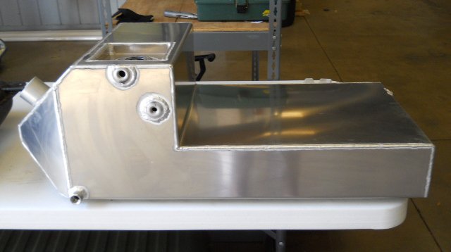

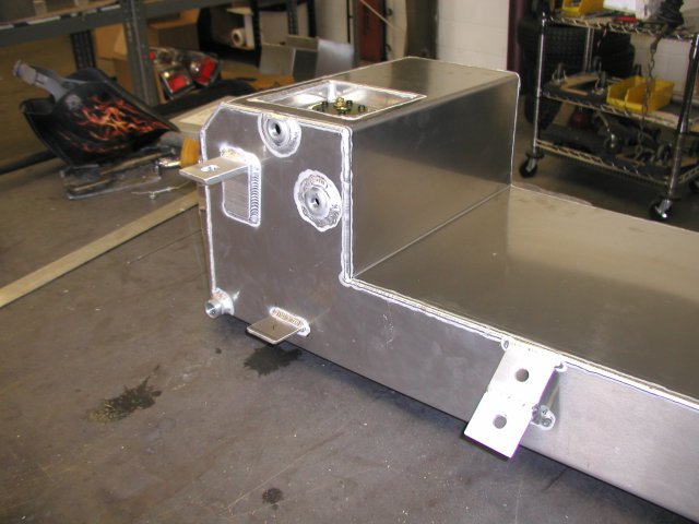

Here's the only "mounted" picture I have so far. I haven't had time to clean up the install and document it yet. Here's a nice clean picture of the tank completed, just before installation. The 1/2" bung in the lower left corner is the outlet, the 1/4" bung up the side of the tall portion is the return, the 3/8" bung at the top is part of the vapor recovery system on a stocker, which does serve as a sort of vent. The tab near the outlet is a hanger for the large -8 prefilter. This is a view of the rear-facing part of the tank. The 1/2" bung is again part of the vapor recovery. There are three vapor recovery connections in all. The third is a 3/8" bung on the end of the short part of the tank. Yes, the drain is a 3/4" bung on the bottom of the tank (I don't have a picture yet), located in the same approximate place as the stock tank.

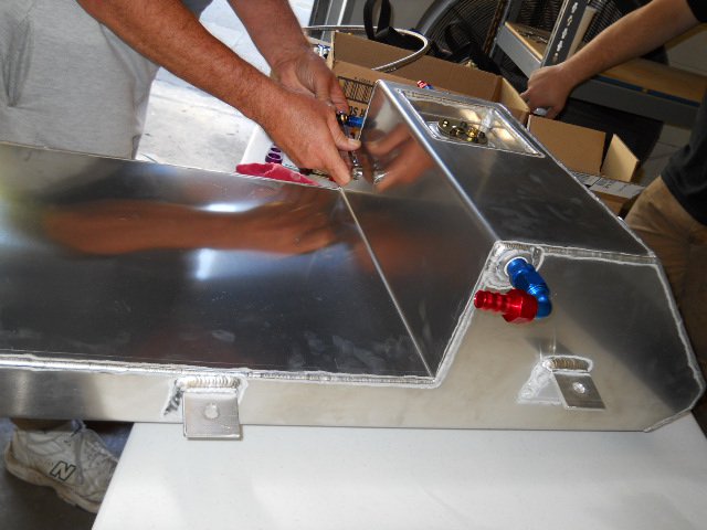

The fabricator has the prints on CAD, and has CAM/CNC files for the build. As I don't expect to ever need another tank, he was welcome to keep them. By the way, the tank is guaranteed for 10 years. Too late on weighing the tank. It's already in the car. We installed it yesterday. Since this was a "first article" build, we fitted the tank to the car in the weld shop, and then welded on the hard point brackets. The dimensions and locations of the brackets were then added to the CAD files.

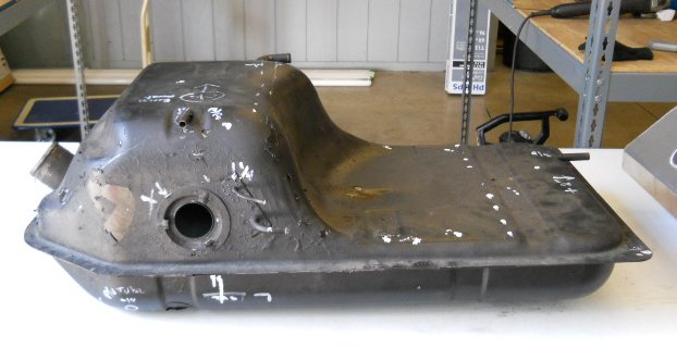

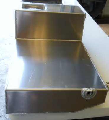

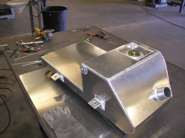

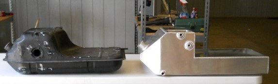

Here is some more information on the fabrication: There were three major design goals, 1) the new tank had to fit the same space as the old tank, without cutting any sheet metal, 2) the new tank had to maintain the same ground clearance as the old tank, and the new tank had to utilize the stock filler arrangement. It met all of these goals. This is a nice-side-by-side comparison of the two tanks during fabrication. The new tank does not yet have its mounting points. This is the passenger side of the tank. Note the filler neck and the well for the fuel sender. Also note that the tank seems to be sitting at a wierd angle. As in the old tank, the rear part of the tank slants upward for ground clearance. You can see that angle better in the shot below. This shot is from the driver's side. The dimension of the tank coming toward you has been lengthened 2" to increase capacity.
I don't know, exactly. I filled it with 3 exactly measured 5 gallon containers when we were done. It took every drop, and seemed to be willing to take significantly more. The stock tank specification was 15.9 gallons capacity, but the stock tank I removed had previously measured 14.5 to the filler neck. It did not have any dents of any size. The aluminum tank fabricator could not estimate a capacity, due to the complex shape of the tank. However, in planning the tank, I had it built 2" wider on the driver's side (the shallow side) to increase its capacity. All of the other dimensions are exactly the same as the stocker. However, since the aluminum tank has square corners, and the stock tank has rolled edges, there is a bit more gain in capacity there. The only loss in capacity would be due to the square corner where the tank comes up to the spare tire well. In the stock tank, it bends around the well a bit. All-in-all, the aluminum tank is bigger, but I'm not certain how much. I will have to drain the new tank sometime in the future, as I was unable to put the Earl's drain plug in due to the lack of a 9/16" allen wrench. When I do, I will get a proper capacity measurement.

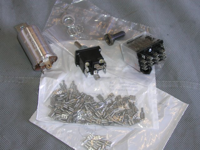

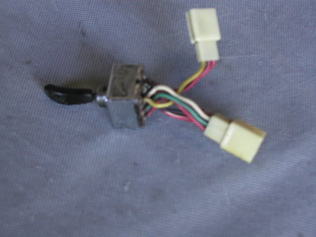

As mentioned, there are no emergency flasher switches to be had for this repair. Attached below in the PDF is the "fix" I ultimately used. This is a hybrid circuit to replace the OEM part. It has the advantage of consisting of readily available industrial components which are actually much higher quality than the original. The relay is rated for 10,000,000 operations, which should be good for something like 4,000 years of regular use. The switch is water and oil-proof, and rated for 15 amps at 12VDC (each pole). The major parts are as follows: 8002K34 oil-spray-tight washdown toggle switch, DPDT, on-on, 15A., quick disconnect terminals @ $27.33 69585K55 compact relay, 12VDC coil, 4PDT, 15A., @ $13.11 70205K26 switch seal and boot @ $3.54 These parts are from McMaster-Carr. The first photo is the stock switch (sorry about the bad photo). The wiring will be cut off the back of the switch, and new quick-connect terminals will be soldered and heat-shrunk onto the wiring. This allows you to connect the hybrid circuit directly to the stock wire loom with no modifications. You can then also remove it for service. The second photo shows the components before installation. There is no picture of the completed installation, as you can't get a camera up behind the dash to take a shot. The completed installation does work in the car, and has improved the brightness of the lamps, suggesting there was some resistance through the stock part. HAZARD SWITCH WORKAROUND 2.pdf
I can scarcely believe it has been nearly a year since I have posted to this thread. Some minor work has continued on the Z, and it has been driven pretty much daily. My project focus has been elsewhere. However, the emergency flasher switch broke, putting the car out of commission. As many of you know, this switch also takes out the turn signals and brake lights when it goes. Anyway, take a look at the posts here for a description of the fix: Hazard Switch Sticky Scroll down to #18, 19, and 20. This is a pretty good solution, if I say so myself.
As mentioned above, my original hazard switch is completely gone, and it has become unlikely that I will find an acceptable original part. The first step toward creating a hybrid replacement is to understand what the original does. So, I spent a couple of hours with a magnifying glass and drew the attached circuit diagram to show the logic of the connections. This drawing does make a bit more sense. However, please note that it leaves out the brake light and the turn signal circuits for the sake of clarity. Both of these circuits are downstream of the hazard circuit, which is why a bad hazard switch takes out your turn signals and brake lights as well. Emergency Flasher Circuit.pdf
As it happens, I've been trying to repair a broken hazard switch. I have learned so far that 1- Nissan doesn't make the switch anymore, 2- there isn't any NOS to be found, 3- used switches are nearly 40 years old and thoroughly picked over, and 4- the original wiring doesn't make any logical sense. I had intended to simply substitute an industrial DPDT and be done with it. At least on a '71, that isn't possible, due to the pervese switching logic of the original. Attached is a reproduction of said logic, copied from an original service manual. Perhaps it will be of some help to you. (Original uploaded file corrected 9/25/10) 71-’72 240Z Hazard Switch Logic.pdf

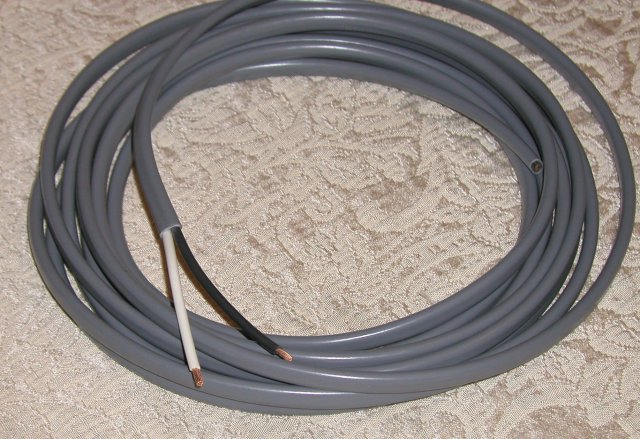

In truth, I don't think we can answer your question. If an electrician did the installation, and he wanted to use a white wire (which is reserved for neutral only) as a hot conductor, he is required to change its color at both ends (usually done with tape). A switched receptacle needs only four conductors: a ground, a white neutral, and two colored hots, one constant, and the other switched. The interconnection tab on the brass side of the receptacle is broken off, and gets the two hot conductors. If your receptacle is an old, non-grounded type, then you only need three conductors. The fourth should be unused. If this receptacle was wired by the previous homeowner, there's no telling what he may have done. The best I can say is that there is no "standard practice" reason those two conductors should be connected. As far as accomplishing what you are trying to do, you need only replace the receptacle or jumper the hot side together, and use only the "constant" hot for both sides of the receptacle. This will free your wall switch up for your fan.
You see mostly black and white because everything tends to be 2 conductor w/ ground Romex these days. However, per the National Electrical Code (NEC) hot legs can be any color except green or white (and some striped variations). By convention, the first hot leg is black, the second is red and the third is blue. Colors such as yellow and orange tend to be reserved for things like switched legs. Control and telecom wiring must be separated from high voltage (which is anything over 70V), so you are not likely to find them in the same box as 110V. A very common residential wire you may find is 3 conductor w/ ground (Romex), which is found in places like switched receptacles. This will have a bare ground, white neutral and a black and red hot.
