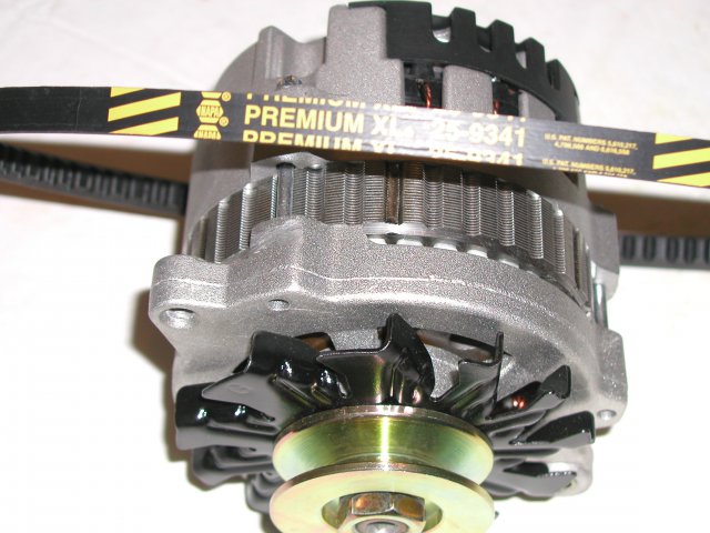

The big belt on the alternator works wonderfully. The car is actually running perceptably stronger. I am going to leave the "Electrical" topic for a while, and come back to it. I am currently building the B+ (positive power supply) buss, and revising the associated wiring. When I have enough pictures, I will post. The next topic will be fuel supply, which has some interesting problems, problems I notice others have experienced.
At some point, you have probably held an alternator in your hands. You probably will remember spinning the pulley by hand, which turned easily. It should, as its shaft is suspended on two good ball bearing assemblies. After you overcome the inertia of the heavy rotor, the shaft spins freely. This applies equally to a small 40A alternator or a big 105A one. If you mount the alternator and put the belt on it, but don’t connect any wires to it, your engine will turn it every bit as easily, albeit faster. At this point, the fan on the alternator pulley is the only significant mechanical resistance, and that is not very much. Once you connect the wires and put a load (an electrical device which uses electricity) onto the alternator, it will begin to produce both voltage and current, which are collectively called electromotive force or EMF. The key thing you should understand here is that the alternator does not produce much of anything unless there is a connected load demanding it. Now here is where it gets counter-intuitive. When a load causes the alternator to produce an EMF, that entire working circuit generates a reverse EMF in the alternator. In practical terms, what that means is that the alternator shaft gets harder to turn. This relationship is directly proportional. The more current you demand from the alternator, the more horsepower the alternator will demand from your engine to turn its shaft. In my Rose’s Ride example above, the stock belt slipped because the big alternator became too hard to turn as the load on it increased. When the smooth stock belt was replaced with a toothed one, which wouldn’t slip, it worked fine until a bigger load came along (the headlights), then it broke. But, you may say, why does the stock 40A alternator not cause the belt to fail? First, the small alternator is self-limiting. It can’t produce much more than 45A (surge), and therefore can’t demand much mechanical force from the engine. Secondly, when you load the small alternator at or above its capacity, you will get a voltage drop. You will have exceeded its ability to regulate its output to its preset maximum value. This is much like a brownout you may have experienced in a city during the summer. When the load on the city electrical grid exceeds its capacity, the voltage drops off. This voltage drop in your car will go from 14.5V to 12.0V, at which point your battery begins to discharge to support the alternator. The trouble is 12.0V is only 82% of your peak voltage and your performance suffers accordingly.* When you use a big alternator, it does not self-limit until 125A (surge). Nor does it go into voltage drop until over 100A. What that means is that the electrical system is performing at peak voltage pretty much all the time. The trade-off is that it takes more engine power to maintain this higher voltage. For me, the trade-off is worth it. The matchbox distributor uses full supply voltage (there is no dropping resistor), so it will perform at its peak all the time. The lights will be fully as bright as they ought to be, the horn will be as loud is it should be. It is my belief that this trade-off literally makes as much horsepower as it costs, and is therefore worth it. Since we are on the general subject, I am going to digress a bit, and tell you about some choices I did not make for Rose’s Ride, and why. In this case, I chose not to install an electric fan and an electric water pump. Before I go further, I will admit I think both are very cool, and both have their proper applications. But I think their application is not on an S30 with a NA L-series engine. Here’s why: The usual reason given for this conversion is to “save horsepower†for the rear wheels. OK, good idea. The water pump and fan use a certain amount of mechanical energy to accomplish some work. That is, they circulate water and air, respectively, both of which are needed, and they are driven by your engine. If we assume that the amount of water and air circulated are the same for both the mechanical and the electric versions of each, then it follows that the amount of energy each uses must be the same, or very nearly so. If you drive the pump/fan mechanically, it will take a certain amount of engine horsepower to do it. But if you drive them electrically, you will still use the same amount of horsepower or more to do the work. Why? Remember reverse EMF from the discussion above? The same amount of horsepower will be sucked up by your alternator to drive your electrical pump and fan. In fact, it will actually be more, because of conversion efficiency. Your mechanical water pump more-or-less directly converts rotational mechanical energy to moving water. But your electrical pump must get its energy from the alternator, which is converting the engine’s mechanical energy to electrical energy. The trouble is, it isn’t very good at it. The alternator is only about 40% efficient in making this conversion. So you really end up using more horsepower, not less, to drive these accessories. Yes, you can adapt. You can use a smaller pump or fan. You can use a thermostat to turn the accessories off when they are not needed. You could even design a control circuit to use when you are racing. All of this is possible, but not, I think, practical for a daily driver. * Note: The voltage drop condition described above is not the same thing as a low voltage condition when the car is idling. Low idle voltage is a problem with the design of the voltage regulator or the alternator itself. My 105A alternator produces a solid 14.5V at idle.
As I noted above, one of the additions to Rose’s Ride was a Z Specialties 105 ampere alternator (thumbnail 1). http://www.datsunstore.com/product_info.php/products_id/1?osCsid=3748af39a3ff513aec6edd48bedbde3f Aside from the sheer additional capacity, it is a modern one-connection design, which is internally regulated. It bolts right in, and potentially cleans up some archaic technology and several potential failure points. As advertised, it was an easy installation, but it came with one very big gotcha. After running the car about 100 miles after its rebuild, the indicated voltage on the car’s voltmeter dropped from 14.5 to 12.0. Some troubleshooting revealed that there was no output at the alternator terminal. Bad alternator, right? Nope. From observation, I would have sworn, truly taken an oath that the alternator pulley was turning at the exact same speed as the engine pulley. It was not. The belt was slipping on the alternator pulley to such an extent that there was no output from the alternator. The car has a lightweight single-groove harmonic balancer and MSA’s billet aluminum water pump pulley. These are both grooved for the stock belt (thumbnail 2). It turns out the stock belt slips badly through the alternator pulley, which comes grooved for a larger belt, which Z Specialties recommends (thumbnail 3). By replacing the stock belt with a heavier-duty one of similar size to stock, but internally toothed, the slipping pulley was cured. However, turning on the lights produced the results in thumbnail 4. The new belt shredded in less than 30 seconds. I will explain why this occurred in the next post. The balancer and water pump pulley were sent to the machine shop to be re-grooved for the bigger belt Z Specialties recommends (thumbnail 5). The long-term results are pending, but I think this will solve it. The next post will go into some theory regarding why this condition occurred, and I will also discuss some design considerations which are not immediately obvious.
