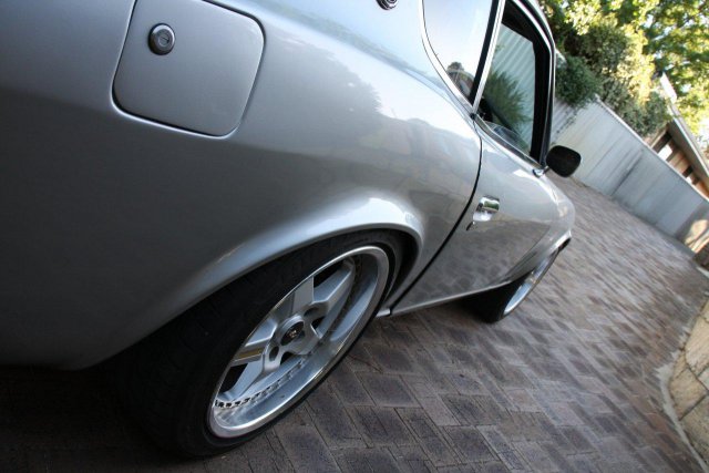

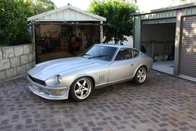

  2. I have the same 5 lug kit and am running 17*9 inch rims with a +17 offset and 235 tyres. Coilovers. You can see from the pics that the front gaurds are flared, but the rims would fit with the std gaurd i think. Rims are aftermarket R32 GTR rims. Hope this helps...
  3. The Silver 5 spoke are 17 * 9 with a +35 offset, could do with something lower. The other set are being tried on and are 17*9 with a +15 offset and just fit! I am running the AZC coilover and brake kit.
