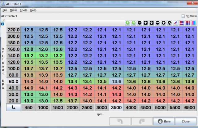

  3. Great info guys, thanks! Chicken, may I see your AFR table, or perhaps you can comment on mine (image attached). I'm in Buffalo , NY where the weather had officially turned to crap, so I'll be focusing on just idle tuning in the garage for a while. General tuning question: If I have Incorporate AFR table (enabled), does making VE table changes work, or does the AFR table take over and basically negate the VE changes? Thanks again, - Liquid

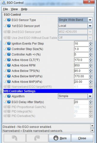

  4. I have EGO enabled but I don't think my settings would effect the car at idle (see attached image). Not sure what you mean by idle VE enabled. I have WUE enabled. I have also attached my current tune for anyone who like to take a look. Note: I did not change my settings last night but noticed the car was much leaner at idle compared to the other night when I was making the changes and burning them. How can that be? It's almost like as I burned them interactively with the car running they weren't doing anything....but when I restarted the car the next day they did take effect. Does that make sense? Thanks again. Original_2017-12-05_10.36.02.msq
  5. Please don't beat me on this one, I have searched all over and have not found an adequate answer. I have my General Settings set to Incorporate AFR table (enabled). I have used VEAL and have a good VE table. Lately, I've been messing with idle and I wanted to lean it out. I have keep reducing VE values in my idle range and it seems like my AFR never really changes...it may lean a little but then goes back into the high 12's or low 13's. My stupid question is, since I have Incorporate AFR Table enabled (which happens to be set to 13.0 for idle), what if any effect will VE table changes have on my actual AFR? I'm starting to think that I could change the VE's all I want, but AFR will just auto-correct to what I have in my AFR table....is that correct? If that is correct, why would anyone ever change their VE table if the have Incorporate AFR table (enabled)? Tonight I will go and change my AFR table to 14.5 for the area where my idle lives, but I still have the questions above. I would appreciate your collective insights. Thank you, - Liquid
