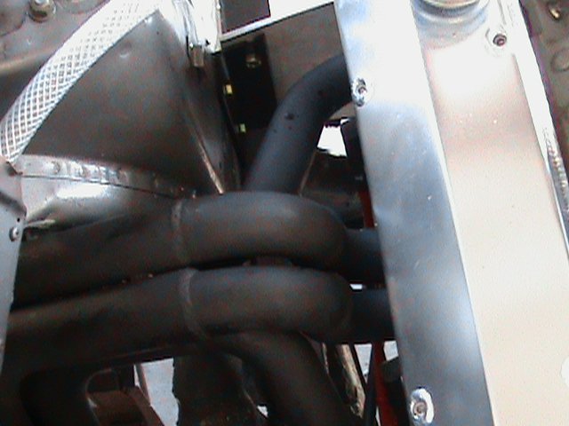

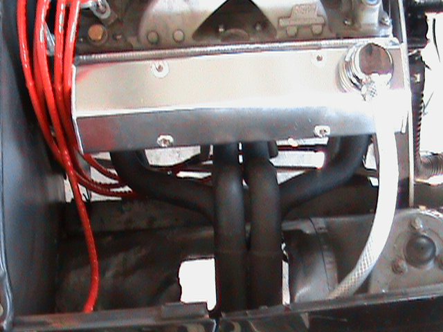

these are schoenfeld with the 90 degree colecters cut short where they join the headers .1 3/4 primaries 28" long with 3 1/2 9" collecters with evac tubes welded in . Wnen short turndowns were added collecters became 16".Bear in mind I am running small skinnies with cross member forward 1"
Thanks LAZYCAT .I am trying to have a collecter that angles more than 45 degrees . This is my shcoenfeld setup with no tire rub with my new tires but I want alittle more setback. (2")

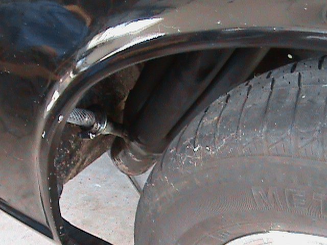

If I make a hard turn and bottom out the shocks they will hit. I will only go straight I hope.I plan on smaller front drag tires tires when budget allows.There is room for 1.5" setback which would give clearence but thats where I wanted the engine.

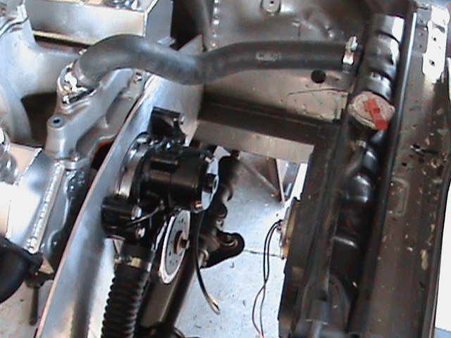

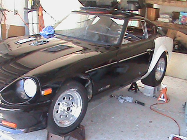

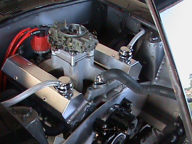

After long planning I finally got engine/trans in. Front and mid plate with shoenfeld 1 3/4 1 7/8 headers , powerglide and a dana 60. I mounted Everything so nothing hung below the front crossmember. I did stretch the wheelbase to 96".
