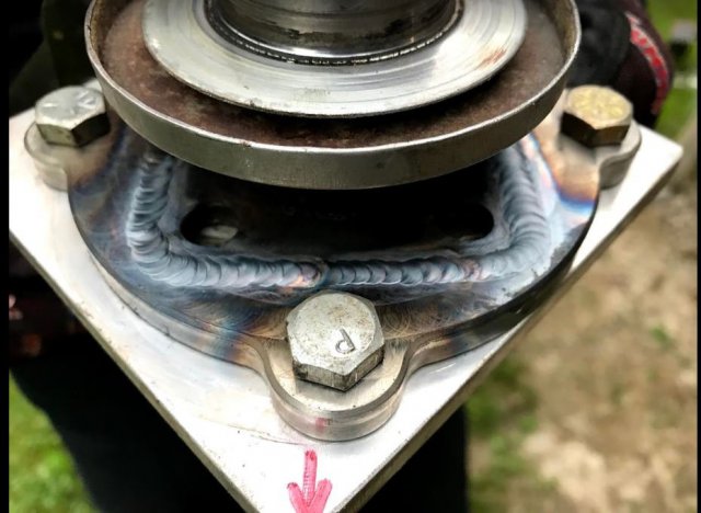

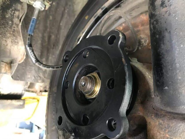

  1. I purchased these a couple weeks ago and rented the jig. Super easy to do and I had a buddy Tig it all together for me. I'm using the 88 SS diff and axles. After flipping the cages the driverside fit perfect. The passenger side has a bit of bind at full droop. I'm unsure if its slightly longer than the standard z31t axles. Mark has been extremely helpful and I wouldn't hesitate purchasing from him.
