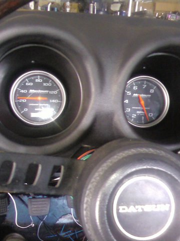

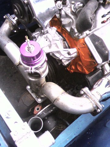

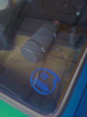

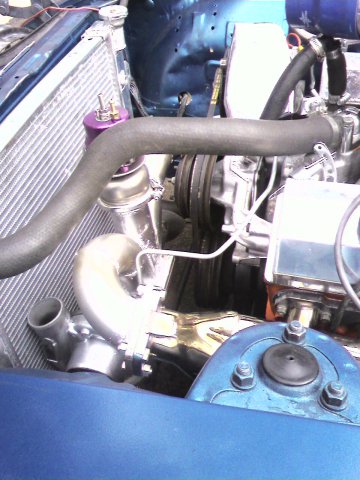

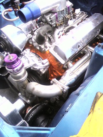

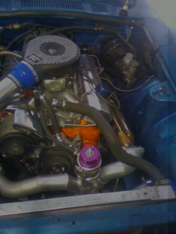

well the twin turbo setup fell through and ended up going with a single. The car put out some amazing numbers at the dyno. It seemed to be the perfect combo of parts. So far is has an aeromotive a 1000 pump with -10 an fuel in and -8 an out aeromotive boost referenced fpr, Modded blow through demon 750, Holley street strip intake plumbed for direct port (175 shot) my excuse to use it is to cool the boost although i have a huge intercooler. Lt1 t56 tranny with spec stage 3 clutch, Lsd rear with 3.7 gears, the list goes on and on but the numbers of the spray on 18 psi The turbo was maxed out i need a bigger one! 638 rwhp 720 rwtq ohh yeah did i mention i got this motor for 350$ 3 years ago and have been running the absolute piss out of it on spray in this car up until now. So far what i know about it is that it is a .30 over 350 with flat top pistons and a step above the rv cam. Stock 194 heads with 1.5 roller rockers. But who knows i got it from some guy with a mullet in a trailer park. Well actually got a 1984 trans am running and driving with a t5 for 350$. Im a newb at this so take it easy. By the way if anyone has a good sized t4 turbo i might want it let me know.
