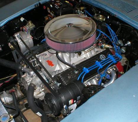

  10. According to my JTR manual, my 78 weighs 2750lbs. With the LT1 eng, Tremec TKO 3550 trans and Lakewood, steel bell housing, I added about 80lbs to the car. (Aluminum heads, intake and radiator). Pretty fair trade-off, since I added an additional 250 hp over the factory eng!
  11. I noticed most V8 Z cars don't have A/C. I plan to bring the car to an auto-air place to have the hoses made and complete the installation. I couldn't find any existing brackets for my alternator and A/C compressor, so I made my own. Any thoughts?
