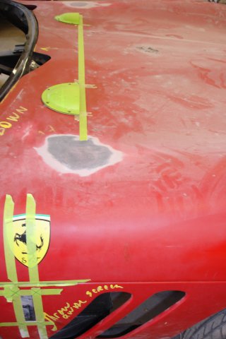

  10. Mine was bad too guys. I purchased the car already complete and the bonnet alone has without a doubt received the most attention during the rebuild (My car is a cross between an old Alpha kit and a newer VR front end). It's the only part of the car that is not finished. Still need to do final fit and then paint. I've had to modify the hood bracket. The "H" design was too weak and had too much flex for my liking. I re-designed it to be an "X". Offering much more strength. The back edge along the winsheild varied in thickness and needed to be trimmed then contoured to better fit the shape of the car. The underside just in front of the wheels also required trimming to avoid contact between the tires and just match up the two sides (a cardboard template worked great). And then I filled and block sanded, again and again and again... Other modifications, but not neccesary, include "D" holes for airscoops, raised centre to accommidate a higher intake madifold (Edelbrock Pro Flo EFI), mounting brackets for the hood latches (KingAir engine cowl latches). I also cleaned up the underside with two coats of undercoating and an aluminum heat shield for the engine compartment (too prevent the heat from warping the fiber glass and damaging the paint).

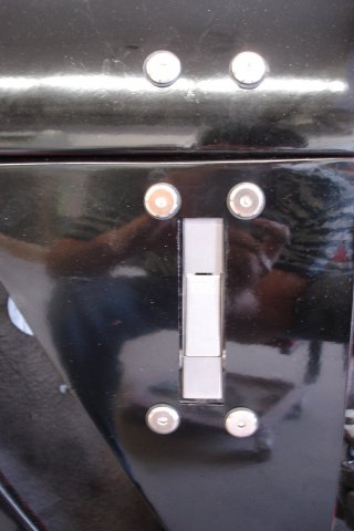

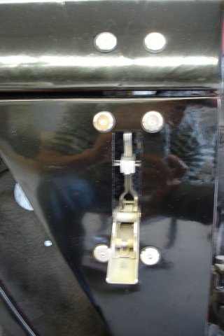

  16. I am too the point where I am ready to put the latches in the hood, I have Chrome pin latches, but they don't pull the sides of the hood close to car. I see that the old GTO's used straps, anyone got any ideas?? TIA. DJ mudjr12, I had a set of hood pins on my car before the rebuild. The same problem bothered me about the sides flexing out. I used a set of engine cowls latches from a King Air 100. I fabricated a set of brackets and cut the required holes. They work great and are fully adjustable. They both hold the hood down and have eliminated hood shaking. The bolts I used are too big for my liking, I'll change them out for some smaller button head bolts.
