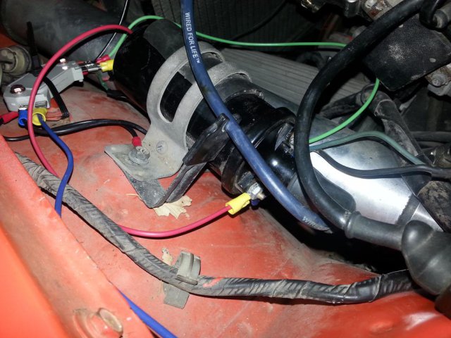

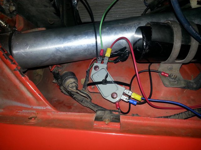

  10. Good news, I've made progress. I did find the exact yellow/white wire I needed. It was very obvious once you described it haha. So I threw the distributor back together. I then tested the my computer power wire and was losing power when cranking. So I switched it to a different spot and have power while cranking now. I then disconnected the the blue wire from the coil. The HEI is wired in correctly. The zip tie in the picture is just the hold it in place. It's grounded through the bolt holes. The coil also has power. After all of this, I finally got spark. But the car still won't start. The spark doesn't seem like its very strong. I test the spark using the screw driver method. On most vehicles I test it's a strong and fast spark. Like spark spark spark spark really fast. That was not the case with this. It was more like spark....spark....spark....spark. I'm not sure if that's just how it is on this engines or what. I also decided to check the fuel pressure in case maybe that was the issue. My fuel pressure gauge leaks a tiny bit so I can't get an exact reading. But the gauge was reading over 20psi. So after you consider the loss it has somewhere between 20 and 30psi. That's about what these pumps run right? So that's as far as I got for tonight. Any ideas now? Maybe something to do with the injectors?

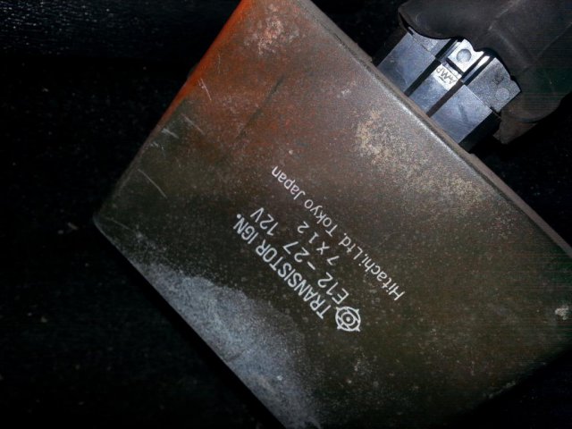

  11. Disconnected the Transistor Ign. Also tested the ECU output. No voltage on either of the yellow/white wires. I'm assuming I should go ahead and replace the CAS sensor?
  12. I'm in the middle of swapping the L28ET into my Datsun 280Z. The computer does have power. I'm using a GM 4 Pin HEI. I have a diagram below showing how I have it wired up. There are two Yellow/White wires coming from the computer. One needs to go to the HEI. I've tried both and no spark either time. I'm using the stock coil from the original naturally aspirated 280Z engine. This shouldn't be a problem should it? Also on the passenger side of the cab, underneath the dash, is a box that reads: Transistor Ign. Is this part of the Ignition system? Hopefully you guys can point out something that I don't have wired up right. If not I might try replacing the CAS. Thanks
