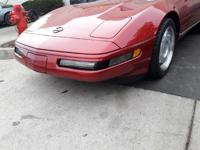

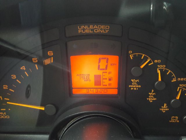

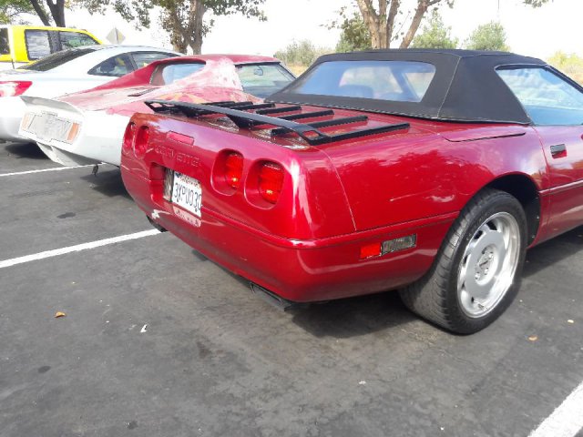

The Motor developed play in the crank bearing, that caused some knocking noise. I went out and found a mint 1994 Corvette with 34k original miles on the motor. pulled that motor and swapped it into the 240z. The whole process took 4 days Including sourcing the motor to cleaning up my driveway. Car runs good again. Then I installed our new Silverminemotors Coilovers, lower control arms and adjustable TC rods. The car handles amazingly now! Also very quiet and smooth. I made a little video of the process.
