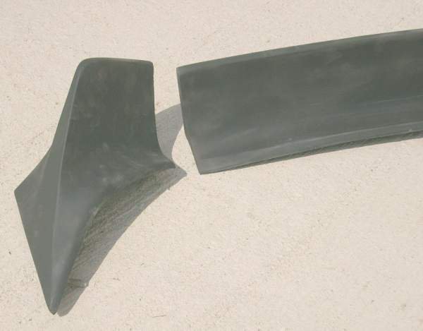

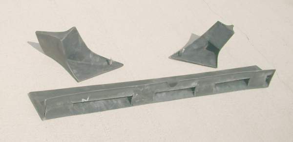

  4. I found the company who make the spoiler pictured above. The company is in Canada . its 259.00 shipped to my door. Here's the link to the page just scroll down and you'll see it listed. http://www.showcars-bodyparts.com/240z.html
