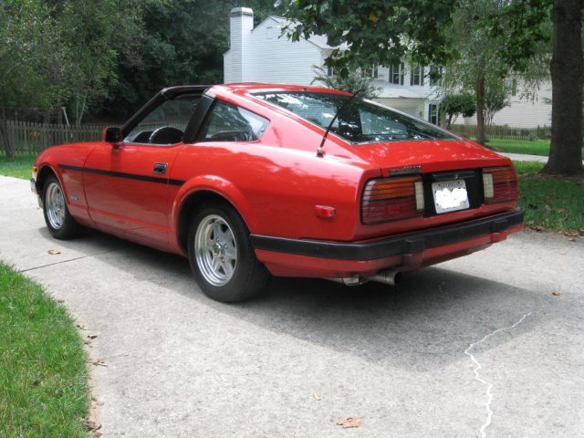

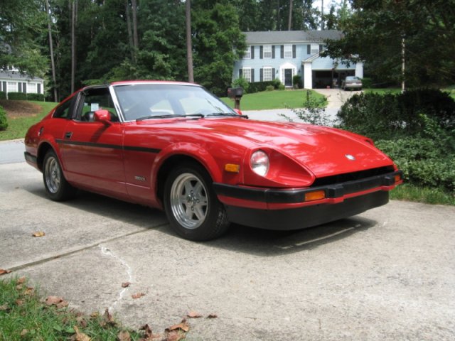

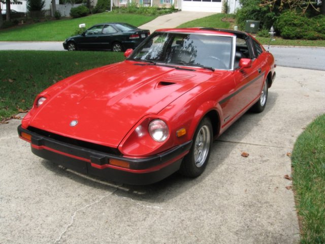

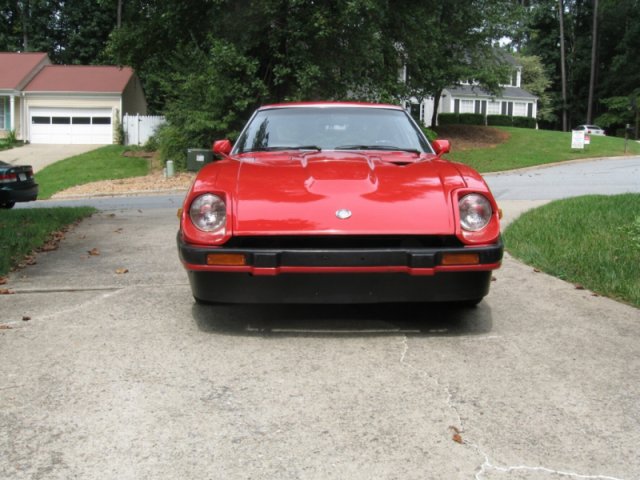

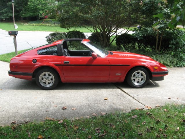

Front and rear bumpers and shock absorbers were removed. The back bumper was replaced with a piece of angle iron, the front one required a bit more fabrication. Then enough was cut off of the side bumper cover panels to allow the covers to be moved in to bolt up to the new bumpers. I wouldn't recommend it unless you're not worried about fender-benders or other mishaps. While the original (heavy as hell) bumpers won't help you much in a real bad crash, they do keep little taps from harming the rest of your bodywork.
Hi guys, here is my 83 NA with new flush bumpers and front end rework. I've had it for about a year now. Just put in a new dizzy - working vacuum advance is a wonderful thing.
