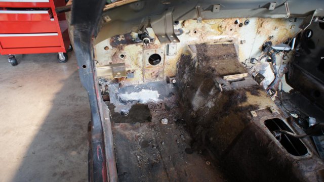

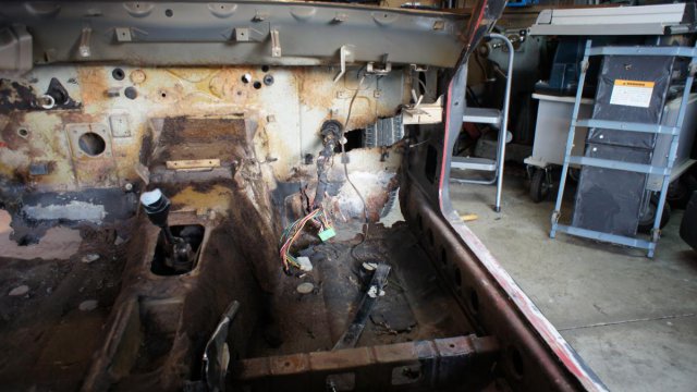

	Pics say it all....rusted, spongy crappy crap Drivers side 1st Passenger side 2nd.. I really dont want to scrap the car, as you are seeing the worst. I am a fair welder with an excellent shop and tools. Here is what I am thinking: 2.5" square tubing all around. Mary up some Badog floor pain rails? I have never done this on a car. Is this thought process correct? 1. level car, measuring level on the door frame sills. 2. cut out front frame at the bend on the top where its spot welded to body work (need repair there also) 3. cut out rest of rusted sheet metal parts 4. repair sheet metal in prep for new frame rails 5. level new frame rails, weld in

	Yes, its quite ugly, and since I posted it has become uglier...I thought I could patch the floor pans, but a total replacement is needed. Soooo.. As for MIG.. I dont have a mig unit at home.. just a tig/stick rig... I still have to pull the engine and stuff...but once that is done I will start cutting and see where we end up....
