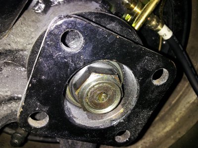

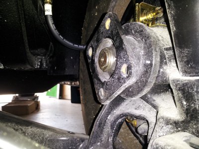

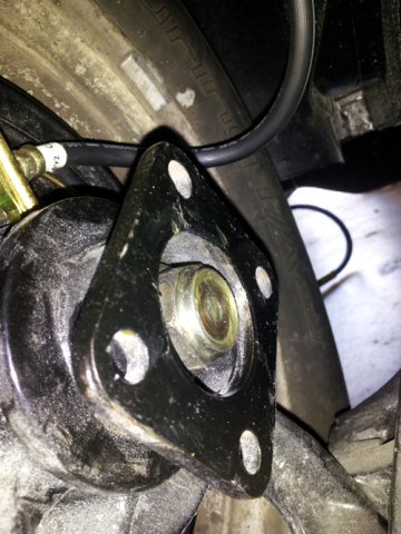

I swapped axels and then companion flanges. the problem followed the axle, I confirmed both spacers are the same and marked the same. I would assume this rules out the inner bearing since that stay in the hub since that didnt move. the only thing I didnt check is the axle lenth itself but I would think they have to be the same.
OK, dissasembled, Confirmed the bearing were seated against edges as far as the would go. retorqued to 180 and now looks like this. still not as far in as the other side.
I am reassembling the rear suspention, I have torqued the nuts to 180 pounds, one of the nuts sits farther one the shaft then the other. I thought I remembered them sitting farther in on the shaft. Does this seem right or could it be when they pressed the bearing they went in crooked?

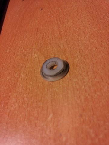

I am looking for 1 of these from 70 240Z door. Nissan calls it a collar-Bell Crank(80515-E4100) for the inside handle rod to open the door. Not sure if all years of Z's used this exact part of if they changed it. as there is 3 part numbers for this in the parts manual.
